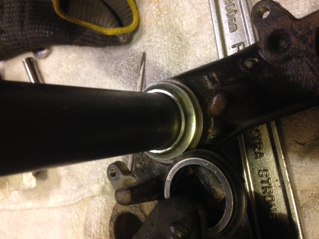

UPDATE! Had some time to tinker today and solved a mystery I was having. the Met stem just didn't seem to sit at the correct height by only 1/4" and my mind was boggled. After taking many deep breaths and starting over at square one I examined every single part and piece with a microscope to get to the bottom of it. FOUND IT!
The Met's lower bearing race(could be the wrong name for it) that's on the base of the stem is different! Causing the bearing to ride too high on the race and ultimately restricting the stem from seating up in its proper location. Also, the bearing cups that hammer into the head tube from the Met are NOT compatible with the SE50 frame.
See pic below of the SE50 lower bearing race on the Met stem...the Met race is removed in my hand. Very slight difference, no wonder I missed that!

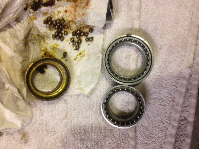

Here are the Met's cups and bearings. Two different sizes from top and bottom. The yellowish SE50 cups are both the same size and Honda used loose ball bearings. Terrible idea.

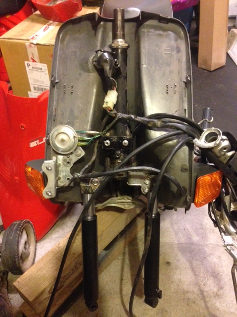

Finally, the Met stem is in its final resting home. Using both SE50 cups, SE50 lower bearing race and SE50 stem nuts on the top.
For the record, I didn't re-install the loose ball bearings. I picked up a new non-loose set...like it should've been.

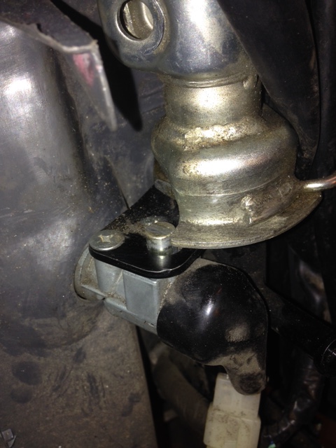

Had to grind away more of the turn stop nub to get the steering lock to work. It was close but the lock peg was off by just a hair. As a guide, the stop nub should be grinded away to basically match the width of the small bracket right above it...see pic.

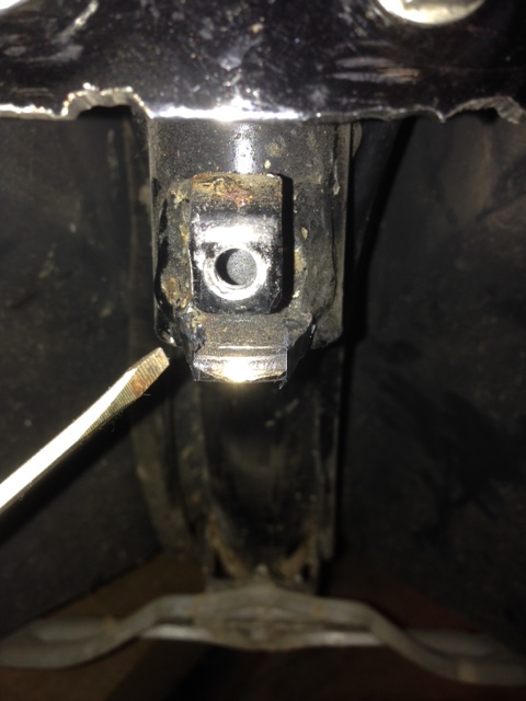

Steering lock works now...sah-weet!
I never actually use it but now I know the turn radius is correct.
