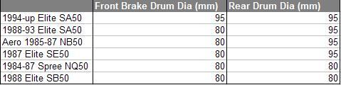

Re: Rims and sizes
eliteguy50 - good topic, there are many differences between models.
Brake drum diameters are listed in the table below. Also, Brake shoe width varied between models, as well as the length of the brake actuating arm. Spree/SB50 has a shorter arm than the Aero/Elites. I think Honda put limits on how much brake a rider got when a handful of lever pull was applied. As Wheelman states the spacer and axle bolt length vary too, beware when picking up parts from other models for all the above reasons.
Data for the table is from Honda service manuals.
I'll put together a table with rim width, brake drum dia and brake shoe P/N tables for the various models.

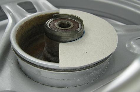

Hmm, not sure what's up with the size differences we are finding. I've dug through the service manuals for the Spree and Elite SB50, both say 80mm for the front drum. Measured my Spree hub at ~3.14" which is ~79.8mm.Wheelman's reply to eliteguy50 wrote: ...Your rim sizes are correct. However the Spree uses an even-smaller brake hub; 75mm methinks
The hub and brake panel may not interchange between models. I think the similar 85-97 Aero/87 Elite SE/88-93 Elite SA50 front wheels and brake panel interchange, but don't have the parts here to verify.eliteguy50 wrote:is the brake drum itself different? Will a rim from one not work on another that is the same diameter?
Between the Spree and 87Aero there are differences. Drum/panels are compatible only as a matched set:
- Spree brake panel / Aero drum - Fails because the flange of the brake panel contacts the brake drum.
- Aero brake panel / Spree drum - Fails because the brake panel will not seat leaving a gap between hub and panel.
I'll post more photos to detail the differences this weekend.
--- mousewheels
Photos below cover the drum differences Spree vs Aero. Last photo shows the brake shoe differences I'd mentioned earlier.

I stand corrected. Less swept area but same 80mm diameter for the Spree vs. Aero. Thanks for setting me right.

Re: Rims and sizes
Couple comments here - My 87 NB50 had 1.5" rims front & rear. Anyone else have a 1.5" rim on their NB50 or pre-94 SA50's? The 86/86 Gyro TG50 front wheel is 1.85x10, but will check an '84 NN50 Gyro, I think it is 1.5x10.eliteguy50 wrote:the nb50, 87-93 elite50 (non sb models) and gyro (front rim only) all use the same rim: 1.85x10 with an 80mm brake hub
Pic below compares the Aero vs Spree front hub. Also can't be seen in the pic, but the brake cable ferrules are different dia. The depth of the casting to the fork seating surface does not account for much of the reduced fork width. Turns out the drum on the Spree is not as deep. Meaning the hub side nestles deeper from the rim edge.
- AeroVsSpreeBrakeHub.JPG (67.34 KiB) Viewed 13816 times

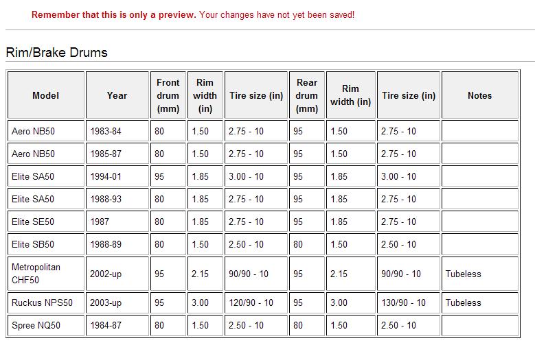

Re: Rims and sizes
Hey - Thanks for adding your infobradthree wrote:The 84 Aero I am currently parting has 1.5" rims
All -
I'm making a table for the 'wiki' from this thread. Changes from early in this thread are the Aero rims were 1.50" rim instead of 1.85"
Couple items to check with the group:
- The Elite SE50 rim has different part number from the Aeros, is it 1.85 wide?
- Added the Met/Ruckus rows, does the info look correct?

Re: Rims and sizes
3.0 is too small for a ruckus rim width. I can measure it when I get home but I am sure it is wider than that.
