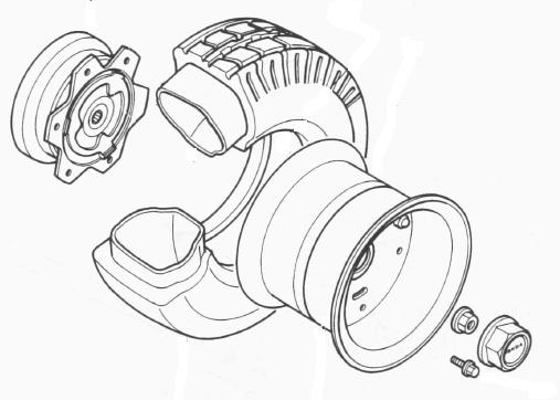

Could be - you are correct on the lug, unless the artist meant it when he left the 6th hole off ;). The outer rim & hubcap look much like our TG50's in the diagram below. This is a Gyro Canopy.

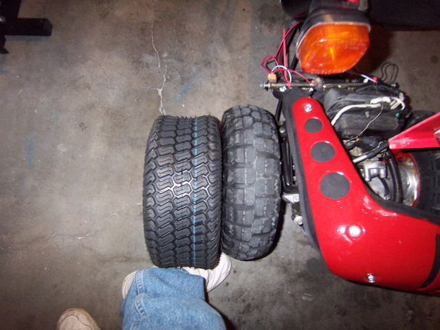

Re: Where to find Gyro tires size 4.50-6 or equivalent?

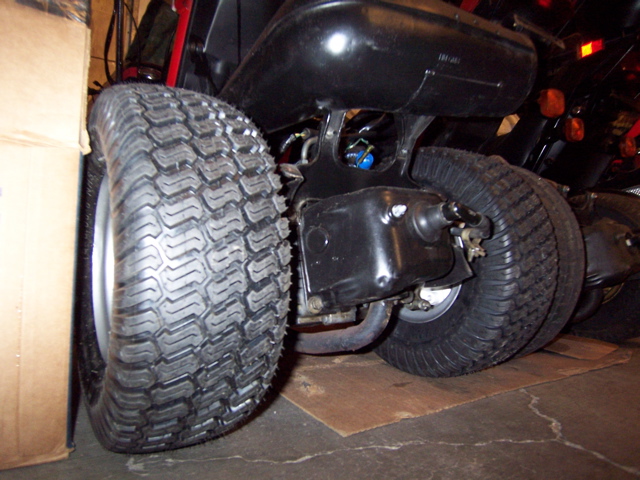

I was at Wal-Mart and saw these tires . and actually bought a set just to see if they would fit .I didnt mount them but it looked really close one problem .. they would rub on the plastic side covers . So I returned them ..
The size was 15x6.0-6/2 and cost $20.00ea. but have gone up in price a few bucks .
And another set 13x5.0-6/2 cost $10.00 ea.
I dont know tires but do you think they would be too wide on the rim ?
Also they are made for mini tractors and wheelbarrels but they do actually look really good .
Side by side w/ Gyro
15x6.0-6/2 @ Wall-Mart

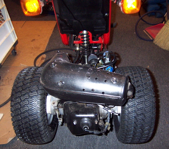

OK here is an update ..I just got another Gyro w/ * tires wrong size too small looked like crap .
So I looked and looked and ended up back at Wal-Mart the local motorycycle shop wanted $39.00 Wall mart $22.00
I also got some tubes at Harbor Freight like $4.00 bucks .Done

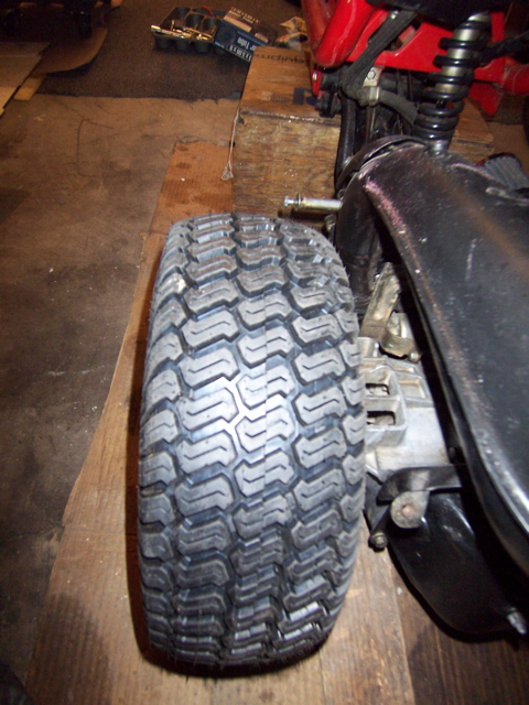

Stuck one on just to see what it would look like .... judge for yourself ... By the way they will rub on the plastic .
How will I solve that problem ....EASY ! ....make some new fenders .
Old & new side by side
Like I said just make some new fenders .
I have not driven on them yet ...so I can't tell you what they will ride like . But the bigger size should make the bike a little faster  as the smaller tires  gave it more pick up but lost some top end .

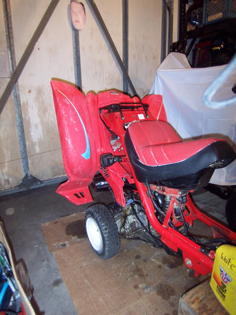

This bike is missing so many parts I think it will be the IRONMAN BIKE .
I just stuck them on to see how goofy they will look ..... Really goofy ....

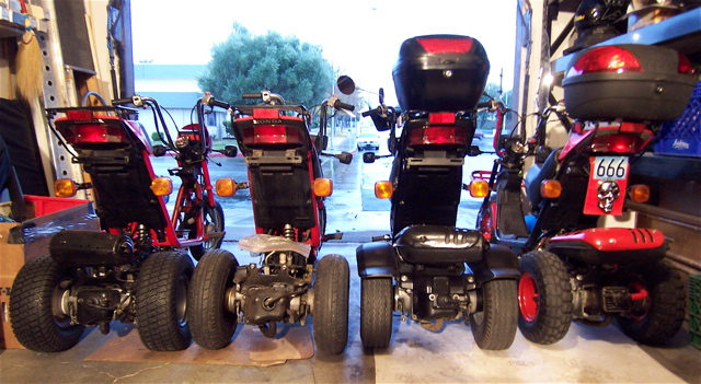

66SIX -- :D :D Thanks - I've been wondering how a Gyro would look with 15 x 6 tires. Custom fenders are a nice touch to go with them.
mousewheels wrote:66SIX -- :D :D Thanks - I've been wondering how a Gyro would look with 15 x 6 tires. Custom fenders are a nice touch to go with them.
OK Stop wondering I finally installed them . If it wasnt raining I would take it for a ride and let you know how they feel .
Done / installed
Done / installed
I like em
I like em
I dont have one set that is the same .
