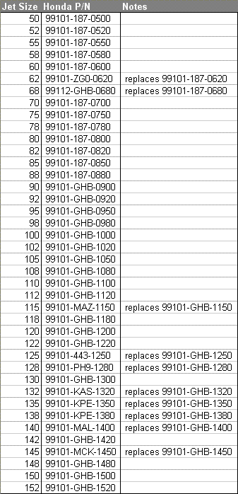

Re: Jet Drilling & OEM Honda Jet P/N's
Bear45-70 has provided a list of factory jets for the Honda OEM carbs. The original table provides prices, about all were around $6 - $8 from his source.
Link to original thread viewtopic.php?f=3&t=14110
-- mousewheels << 05/27/2012>>
Members report fit issues with the -GHB jets. Only -GHB jet I can find which crosses to a PA carb is the 99112-068 jet.
--- << Bear45-70 writes>>
IMO, drilling jets is a poor practice at best. Jets are flow rated and not just a hole of a specific size. If you look at an unmolested jet it is chamfered (tapering into and out of the hole). Drilling destroys the smooth flow. Order jets form Honda or better yet one of the aftermarket guys.
Here is a list of the 99101-187-0XX0 jets available from Honda.
