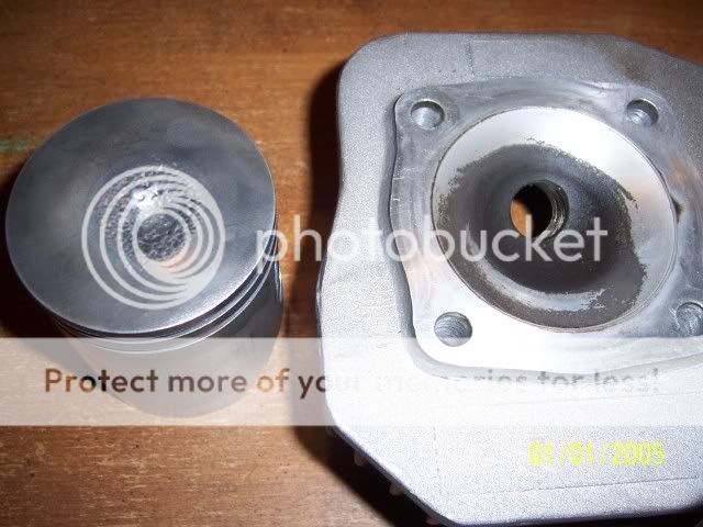

Well, the motor was running beautifully when I down jetted to a 20 slow jet and 155 main jet using the Burial exhaust. The bike idled and there was no bogging, but every once in a while recently it would soft seize. It did it again after a 20 minute ride, and I decided to have a closer look:
The arrow points to an indentation in the cylinder crown.

Re: Super Dio ZX AF28 build (not so super on the last page)
Sorry, Sanj! What spark plug?
Dude, weren't you running like a 40 Pilot at one time? When'd ya get down to a 20?
F3 Nikasil liked a 25/165.
The 40 slow jet was with the PG Typhoon pipe, and when I used that on the Burial pipe the plug was soaking wet.
The spark plug I'm using is the BR8HSA.
I think I see where your extra air might have came from.the vacuum nipple caps.one of them has some big cracks on them.plus I think that pilot was way to small. Are you straight premixing too?
the rubber vaccum cap has hairline crack/ tiny vacuum leaks will cause to run lean.
20 p jet is small and cause motor runs hot.
it is a wrong plug to run BR8HSA.
b8hs or b9hs.
b8hs or b9hs.
Yes, I was straight mixing a 32:1 ratio. Also, I recently switched to Motul 710 about four tanks ago.bakaracer wrote:I think I see where your extra air might have came from.the vacuum nipple caps.one of them has some big cracks on them.plus I think that pilot was way to small. Are you straight premixing too?
I just checked the vacuum nipple caps. They have cracks in them, but the cracks are on the surface only. I'll jbweld those vacuum nipples to get rid of any possibility of leaks at those points.
Yeah, I just got a 22.5 jet in, but hadn't installed it:-(veedubh20 wrote:the rubber vaccum cap has hairline crack/ tiny vacuum leaks will cause to run lean.
b8hs or b9hs.
I'll order a bunch of B8HS plugs, and thanks for all of the advice/tips.
d***, and it was running so well.
- Trafficjamz
- Posts: 5013
- Location: Eastlake, MI
They always do right before this happens.sanjuro wrote:d***, and it was running so well.
Too lean slow jet.
