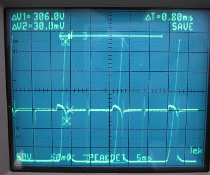

I have not checked for pin compatibility with the Spree CDI, but the schematic diagram is roughly similar. However, there's lots of design latitude possible within the coils, as well as polarity and amplitude of the pulses. We have scope photos for a Honda CDI, it would be good to see a working Razz before making a substitution. Isn't that Vantage Pro you have just the tool to record and compare waveforms?
http://www.hondaspree.net/phpBB3/viewto ... ge#p104274

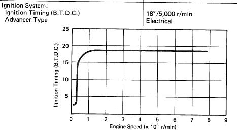

The Razz which is the subject of this thread has a CDI with an advancer. The service manual gives a graph of advance vs rpm. Do you have links for info on advance curves? That's one of the differences I think would be interesting for all.Newer CDI boxes may have a circuit built in to retard the ignition to make it easier to start, and advance the ignition at high RPM for max power. I don't believe these little 2cycle motors have any of that.
- YamahaQT50_Ignition_Stator_and_PulseCoil.JPG (23.97 KiB) Viewed 6556 times

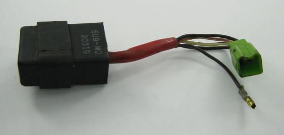

Trafficjamz - hey how's the CDI project?
Also does this CDI look like it will fit your Razz? Its from an 80's Yamaha scooter.
- YamahaCDI.JPG (10.38 KiB) Viewed 6519 times
