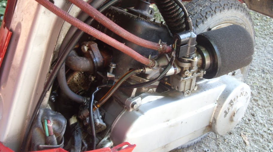

Can you post up some pics of the left side of the engine? The area around the carb, fuel lines and the carb.

Picture time:

is it possible that a vacuum leak could get worse when its warm?

One last suggestion is to replace and/or find the covers that go over the bystarter. At the same time look over and check the operation of the bystarter. The covers are designed to keep the bystarter warm and prevent it from choking the motor with more fuel on restarts under warm conditions.

Well-written. That's why I wanted to see some pics. Sorry I didn't get around to making that comment myself in time.The covers are designed to keep the bystarter warm and prevent it from choking the motor with more fuel on restarts under warm conditions.
