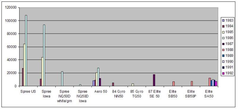

FYI, there were a * of a lot more Iowa Sprees made that I ever thought. Close to 140,000 made with 1986 being the biggerst number at over well over 90,000 built. They also had the restricter washer in the exhaust pipe.
