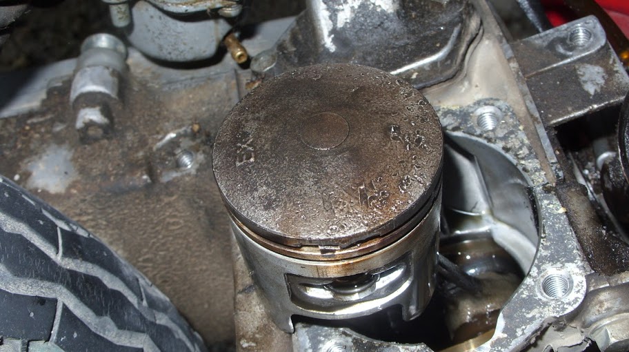

Starts cold, runs, hard time restarting when warm.
Re: Starts cold, runs, hard time restarting when warm.

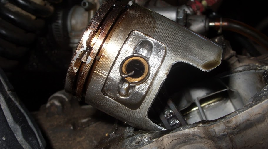

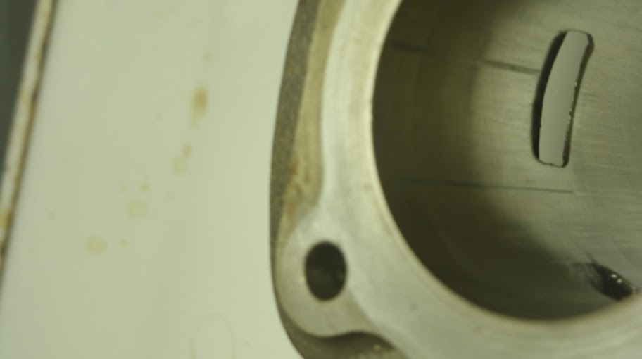

I would suspect you have done some damage to your bore from being too lean. You need tio pull the jug (cylinder).

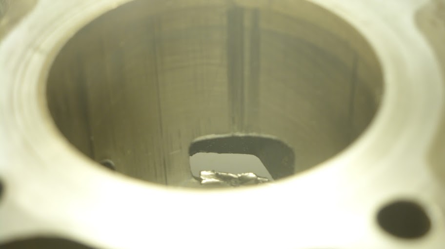

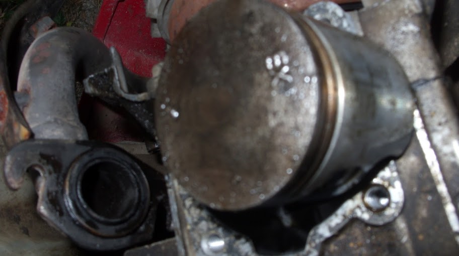

Damage report:
Too lean and melted the piston.

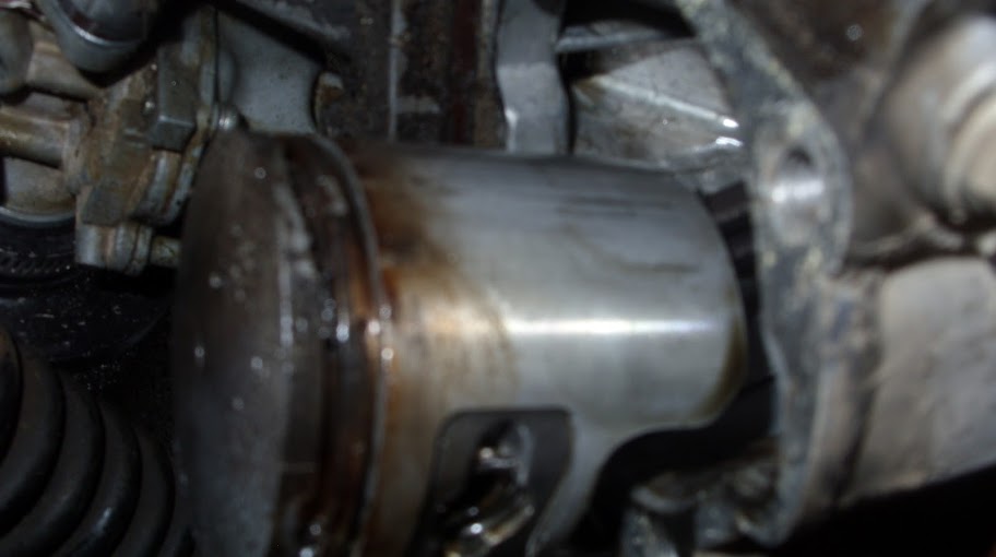

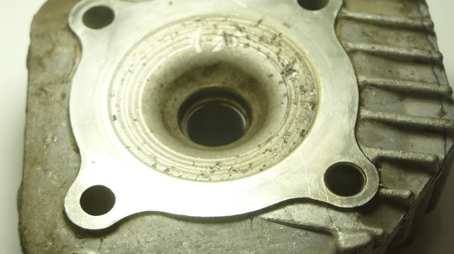

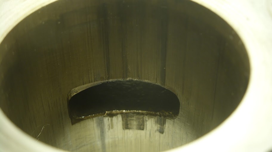

What do I need to do to fix it? Is any thing salvageable? It's it time to just learn to live at 41mm?

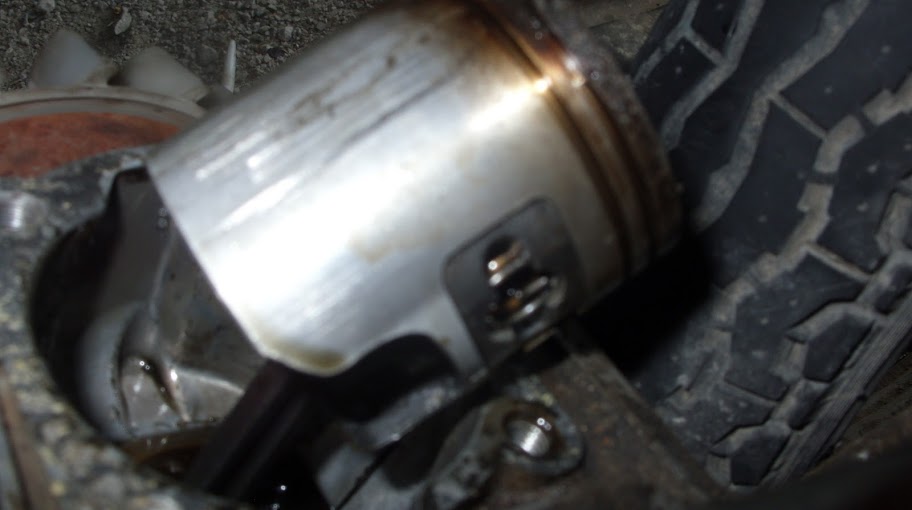

jsun3thousand wrote:What do I need to do to fix it? Is any thing salvageable? It's it time to just learn to live at 41mm?
Your piston is BACKWARDS!!!! :*:

to answer your question.... get a different jug, piston is retired. make sure to split the case too.
It sure is and probably at least attributed to the failure.

So... on pisto heads, ex faces the exhaust?
jsun3thousand wrote:So... on pisto heads, ex faces the exhaust?
Yes.
