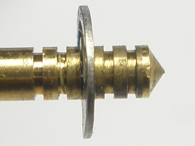

Here's a pic that may help. The clip is about 0.012 thick, and fills the slot pretty well. The needle is 0.080. You can do some pixel work comparing the shaft to slot thickness and come up with an exact figure. Totally off the cuff, a guess is a 1/16" e clip (maybe 1.5mm is better). But the thickness is going to be a factor. Someone here may have a spare clip for you, that would be the easy route...

Oops, sorry to confuse everyone. I'm not talking about the little c or e-clip but rather the thing shaped like a "W" that sits on top of it between the c-clip and the spring.
Thanks for all the help and offers so far though!

i actually have that whole assembly if you want it. its part "2" on the carb microfiche.
i'll just send the whole needle, retainer, c-clip in an envelope just in case you lose anything else...i dont even have a spree anymore. pm me your addy
