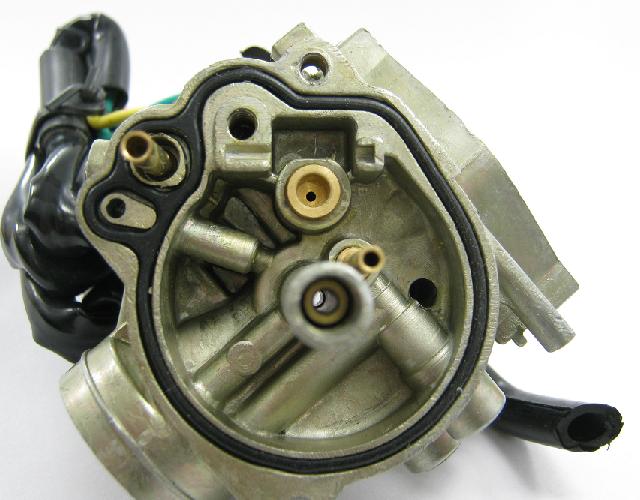

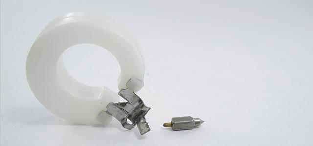

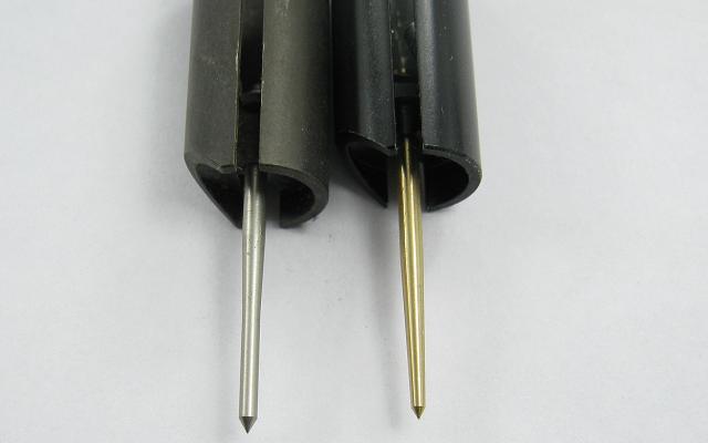

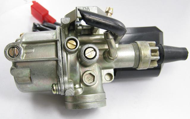

My clone carb is 2+ years old, but the pictures show some of the design changes and differences.
This carb was sold as a drop in replacement, no tuning required. But did not run correctly. I pulled it apart, found a main jet, throttle needle and emulsion tube would be needed (to get those parts to match the OEM carb). Plus it was not running correctly at idle (cold idle way too rich, warm lean) Adding up the costs, and that the float, float needle and seat were different, I found another OEM carb to rebuild.
The fallback of using it's bystarter in an OEM carb did not work. It fit, but the needle and brass collar for the air valve were visibly different. Idled too rich when cold, would not run w/o babysitting the throttle. Since the Clone carb was having the same problem - maybe the clone bystarter was bad? Or possibly the engine it was turned for had different needs?
Could be the carb S4Patrick found is a closer, but buyers beware.
Photos:
Just like S4Patrick's linked part - this one carries no mfg identification or carb calibration tag other than the letters "PA". BTW - Inside, they didn't even mark the size on the main jet :lol:
Float seat is brass, but not a replaceable screw in part
Float itself has a metal tab to actuate the needle. Take a look at the twist near the inside of the float, it looks hand adjusted to the needle. The needle is all metal, rather than a soft tipped design. Which clone scooter would we guess at to get replacements?
Left: OEM throttle needle was stepped (from the tip - straight, then a taper. Clone is a straight taper
