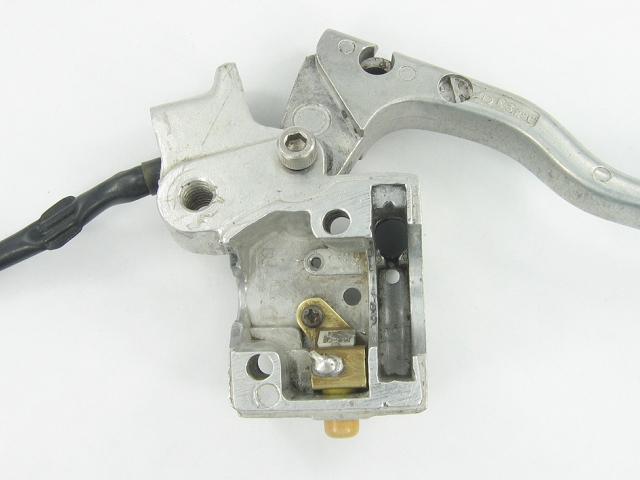

For the turn signals and horn - one question - is your battery in good shape, fully charged the fuse is working and the terminal - to wire connections good? Neither will work well with a bad battery or fuse.
The starter switch sounds like it is not making good contact - since your bypassed switch is working fine
-- Start switch cleaning --
You can probably fix this problem w/o spending $$$, just some time working on your scooter.

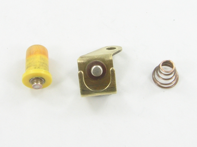

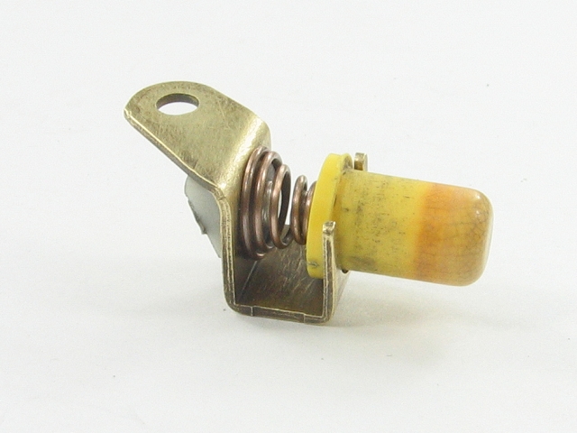

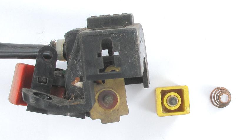

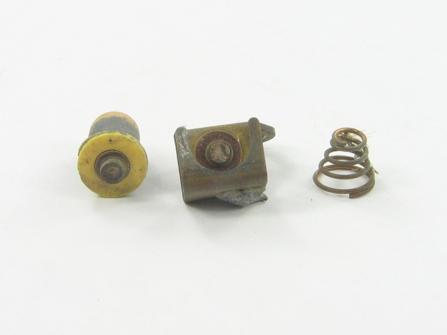

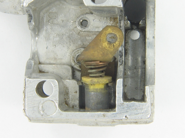

Thanks much to 'Bradthree' :thumbwink: we have a good example of a start switch in need of reconditioning. Bradthree donated a huge box of parts for Hondaspree to use for photos, and we'll have a good fall and winter going through them. Fall/winter is a the best time to think about fixing what's 'kind of working' or even 'not yet broken', you can recondition your electricals alongside the examples Bradthree provided.
Probably all that is needed is a dis-assembly and cleaning/polishing of all electrical contact areas. On this switch, I've used from toothpaste to metal polish and Scotch Brite pads (in that order) for the cleaning/polishing part.
Un-soldering the wires is not required, but can make the job easier, and in the end more reliable - flexing as the contacts are cleaned can fatigue the copper, leading to broken wire strands. That's worst case, let your judgment, and inclination to solder be a guide. If you'd like to avoid soldering, try to keep the wire flexing at the solder joint to the 'not much' side.
All it takes, is a cleanup of all the contact surfaces
  • Spring to switch frame
  • Spring to button
  • Button contact
  • Insulated contact on the switch frame
Ready for the wires to be re-soldered, this switch is ready to go.

Re: Electrical Help 85 Aero
As for the battery it has to be good. I don't have a kick start (85 aero) so the battery has to be good enough to start the engine. I
Ah - , you did say your starter works with a bypassed switch, and the brake light works, As you say, Battery must be good, Fuse is fine...
The headlight high/low beam is powered by AC stator, so them working vs your DC powered items like the horn or start switch are independent issues. *Possibly* a bad frame ground on the thin green wire or at the battery is worth checking.

mousewheels wrote:For the turn signals and horn - one question - is your battery in good shape, fully charged the fuse is working and the terminal - to wire connections good? Neither will work well with a bad battery or fuse.
  • Spring to button
  • Button contact

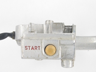

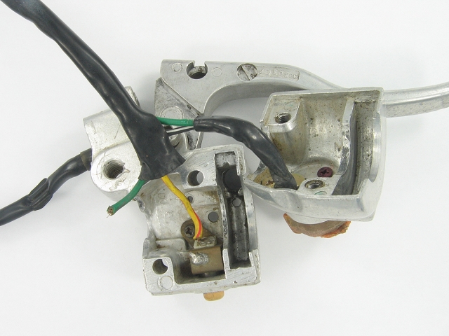

These are great pictures of a Spree but...... The problem is with an Aero completely different setup.
martynkim wrote:These are great pictures of a Spree but...... The problem is with an Aero completely different setup.
Good point martynkim Glad you pointed that out :lol:
Here's an Aero switch - Very similar construction for the electrical parts. Same sort of problems and clean up... I'll clean up all the parts and shoot a set of photos for the Aero assembly.

Yep that's the aero starter assembly. I took it apart today and found out it is no longer wired, so I wired it back up. Next I will clean it the contacts and if that doesn't do it trace the wires back. I think I solved my horn problem. The problem is...there is no horn unit. I'll have to locate one. Here is a pic of the buzzer that was installed instead? (black thing near bottom with loose pink wire)
