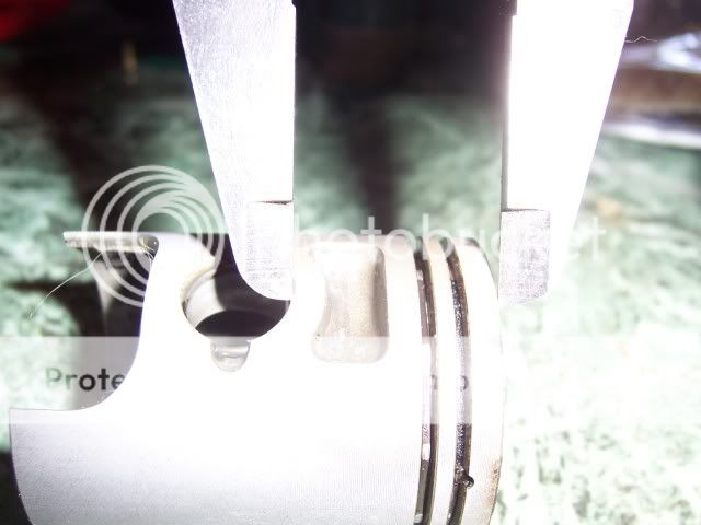

I am looking for the dimensions of the piston for the NQ50 and SA50. I order a new piston kit for my Zuma and received the wrong piston and rings. Pictures are a plus, please include weight in grams if possible. Somehow I ended with a 40.50 piston and rings stamped 1.50 over. If the dimensions match I'll bore your cylinder to match the piston for a reasonable price. To clarify the piston I have is 40.50. Trafficjamz can you hook me up?

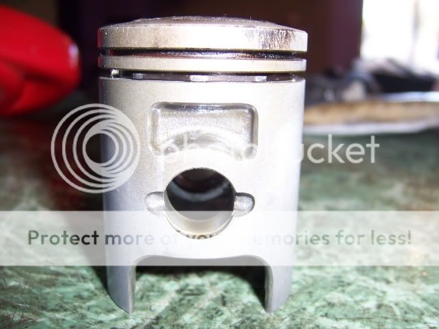

Great info mousewheels. Mine is a 10mm piston boss. What I'm looking for is the height of the piston. And the Spree is 41.00mm also. Dose this look like a Honda piston? The one on the right.

Hmm...Pin looks low for a Honda Spree or early SA50 with a 10mm pin. Top of pin to top edge of piston is about 0.575"
Re: Dimensions of piston?
39mm af16e stock piston 58.2g on my scale
41mm nq50 stock piston 50.8g on my scale

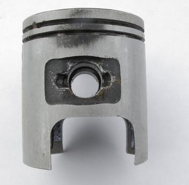

the one on the right looks like a elite S piston

Do you have a picture of the Elite s piston?

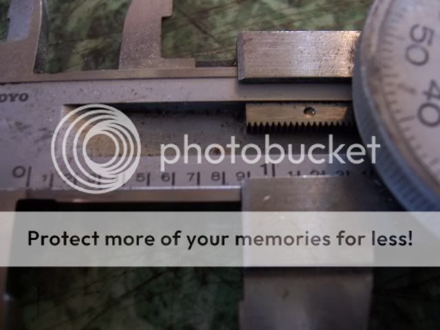

mousewheels wrote:Hmm...Pin looks low for a Honda Spree or early SA50 with a 10mm pin. Top of pin to top edge of piston is about 0.575"
Thanks, mine is 24.50mm.
2007 CH80
.86 inches = 21.84400 millimeters

I was measuring from the top of the crown when I had 24.50mm. I believe we have now measured in the same location and came up with equal numbers. If our numbers are correct I'll say these are the same piston.
2007 CH80
You guys took nearidentical photos. Wee bit of scaling and we have this :D
mousewheels wrote:You guys took nearidentical photos. Wee bit of scaling and we have this :D
Wow that is weird :confused:
My piston only weighs 58.2 grams. Yours is 64.5 grams. I wonder why that is?
I hope you use that scale to weigh other peoples bags :naughty:

Yours is not a 39mm stock piston?
