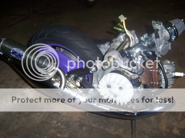

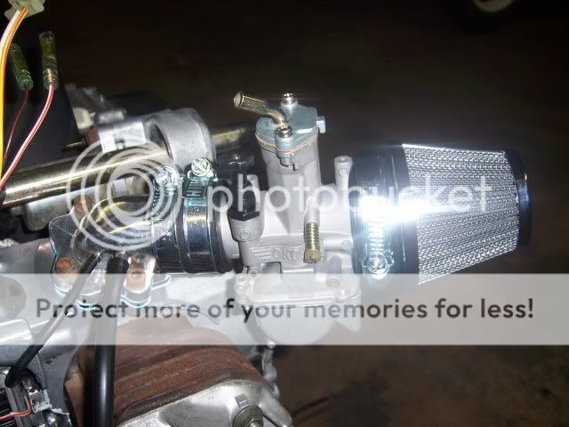

Re: Just got a 1996 yamaha jog
Got more goodies for the jog build.
The motor has been cleaned up a bit too.
