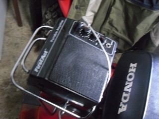

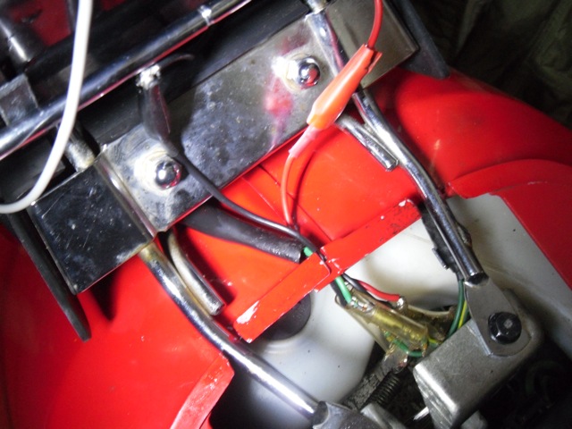

So this is pretty much my build thread and i was updating that: I just added this sweet guitar amp speaker to my rear rack! is super loud and you can hear it even while your throttle is WFO and has pretty nice quality sound :rock: it was a cheap first act portable guitar amp that runs off 2 9v batteries, you can leave it how it is or do like i did and wire it in to the rear running light:wink:
what you need:
-Cheap walmart amp that runs off batteries (combined voltage must be at least 12volts!)
- 1/8 inch jack auxiliary cord for ipod
-1/4 inch to 1/8 inch adapter jack for the amp, at radio shack for 2.99
- double sided tape, rubber bands, or brackets just something to hold it to the rack
- soldering iron
step one: solder all the negative battery connections to negative and all the postitive to postive
step two: solder in two 10inch lengths of wire one positive and one negative
step three: lift open the seat and locate the solid black(positive) and solid green wire(negative) going to the brake light
step four: strip an inch off your positive and negative wires then unplug the green(-) and black wire(+) and only wrap your wires around the exposed end of the bullet connecter then plug them back in to the connector.
step five: turn your key, plug your ipod in, pic a song, and turn your amp on and see if it works, if it does trim down your wire to the length you like and (optional) solder the wires to the running light wires and your done!
1985 aero 50
ported
custom exhaust
ruckus vario
1K polini clutch springs
hopefully nh80 powered soon!
bc117
Posts: 173
Joined: Thu Jan 13, 2011 8:04 pm
Location: camas, wa
Re: 1985 aero 50 mods
Post by bc117 »
heres some pics sorry if theyr alittle blurry :confused:
Post by bc117 »
some more
