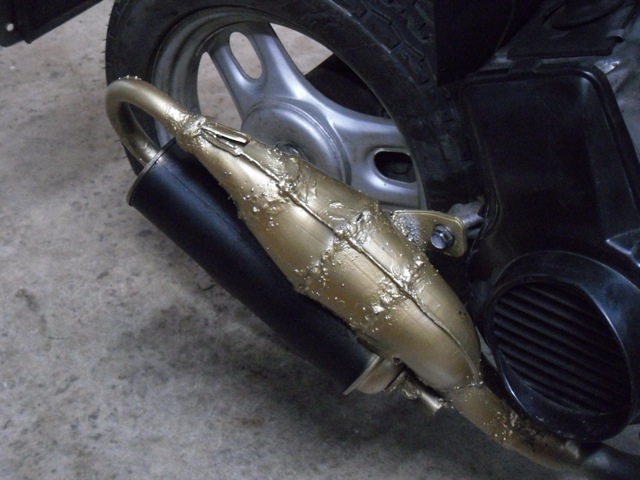

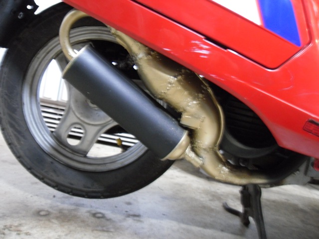

hey heres my pipe finally got a pic, and sorry for the hideous paint job just put on something to keep it from getting rusted out, just wanted to show how compact it was and it actually turned out pretty quiet

Is that a spray paint can silencer? If so I like it! may have to do something similar on my cub.

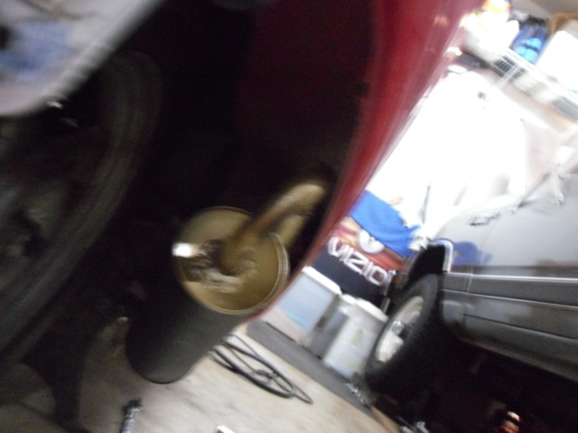

lol ya its a big brake cleaner can with glass insulation heres a pic from a dirt bike exhaust i made awhile back
