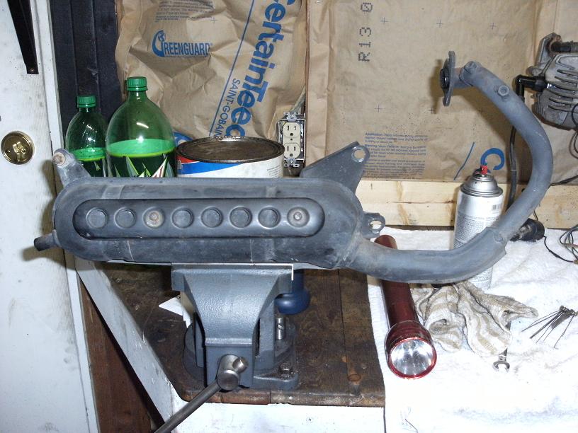

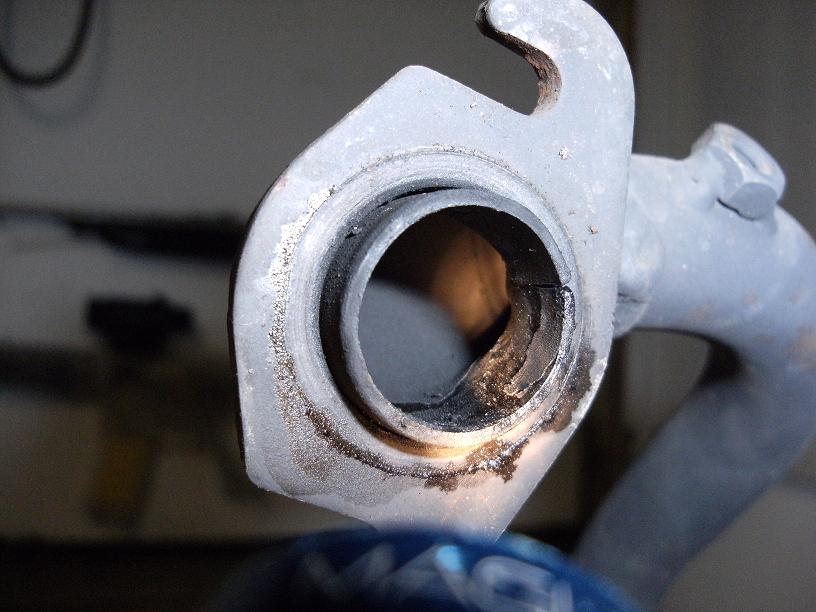

Re: Iowa spree
Are you sure the exhausts are non-Iowa? look for the restriction washer in the mouth both the exhaust pipe.

Post by fatrat440 »
Pictures of the non iowa exhaust.
1984 Honda Spree Iowa.
1986 Honda Spree Iowa.

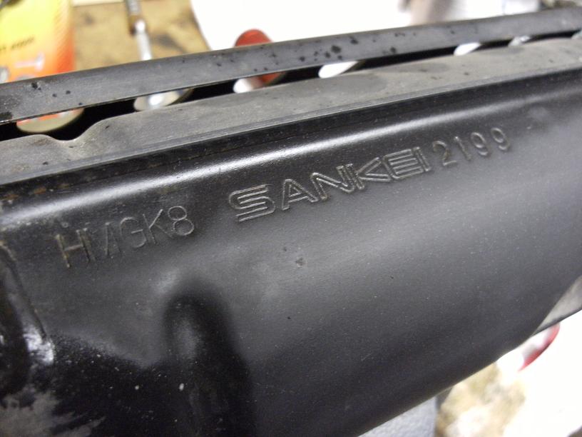

fatrat440
Posts: 57
Joined: Tue Nov 09, 2010 12:05 am

Post by fatrat440 »
another pic.
fatrat440
Posts: 57
Re: Iowa spree
Post by fatrat440 »
and....one more.
Re: Iowa spree
Do you have the stock spree intake and reeds?
Try some from an elite e. (sb50)
They flow better and may work better with the 68 jet.
