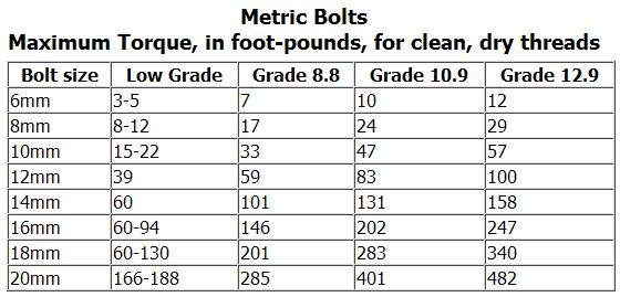

Torque is in the ballpark with 1987 SE50 which was 72-87 ft/lbs
85-87 Aero50 was lower at 58-72 ft/lbs
Axle thread dia is stated at 14mm. Aquick search gave a generic torque table with 80 ft/lbs looking ok. Assumption being the axle steel is better than a low grade.
