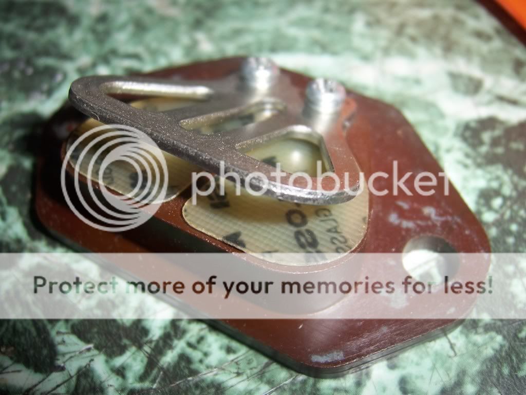

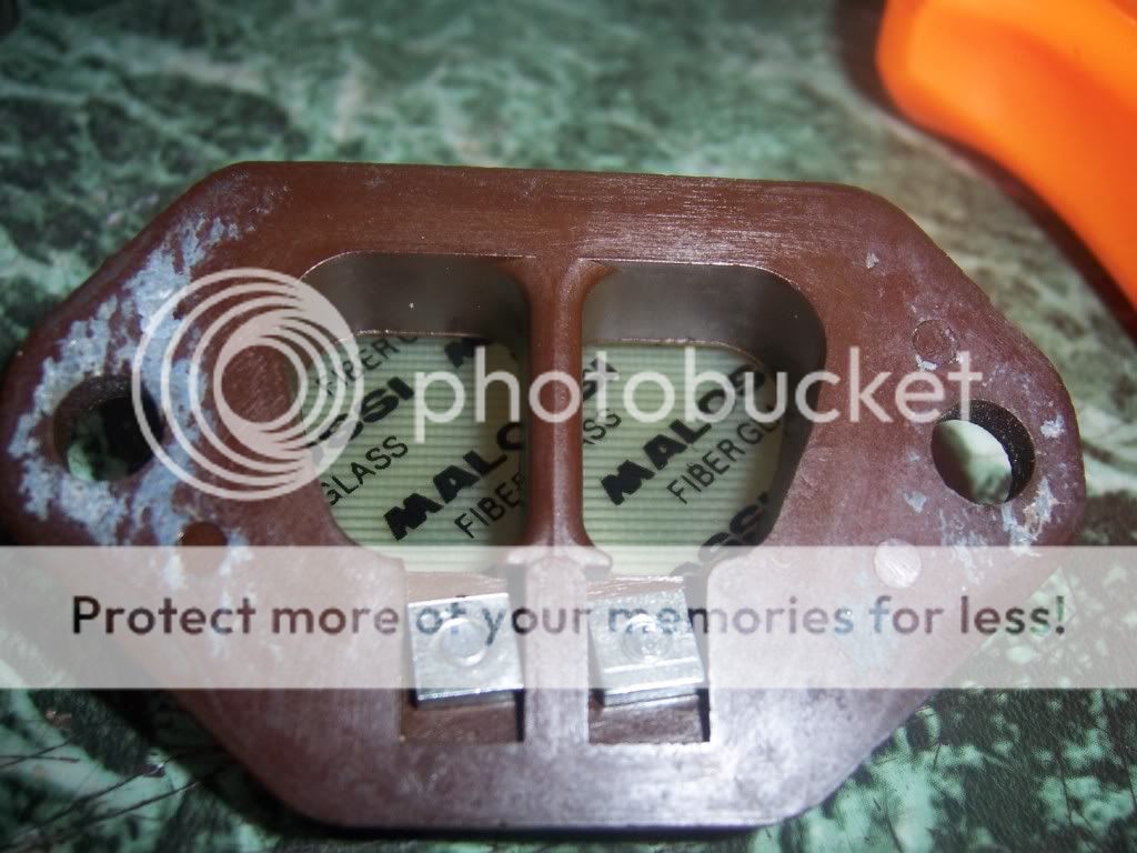

SPREEtown wrote:these fit sb50 reed block? do you have a part number?
Yes they do!
They came with a Malossi BBK for the Variated AF05E. :thumbwink:
And these are NOT for sale. :smile:

http://cgi.ebay.com/MALOSSI-HONDA-FIBRE ... _600wt_899
can't tell if these are the ones. ad says they fit the vision block.

SPREEtown wrote:http://cgi.ebay.com/MALOSSI-HONDA-FIBRE ... _600wt_899
The vision ran both the af05e and the af16, maybe more throughout the years.
Re: Spree upgrade path - input needed
They look like the right ones......don't know what the vision is.
Vision was the Euro name for the Aero. AF05 (methinks...) in the Vision, AF16 appeared in later Vision "Met-In" - another wacky Honda-san Euro name - models.
