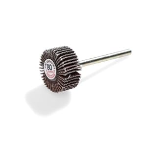

Re: Modifying Exhaust Port
Bugaboo wrote:I know that you want the exhaust port smooth as possible. What is the proceedure for smoothing? Some kind of polishing compound or wax?
I used 3m flapwheel 120 grit
