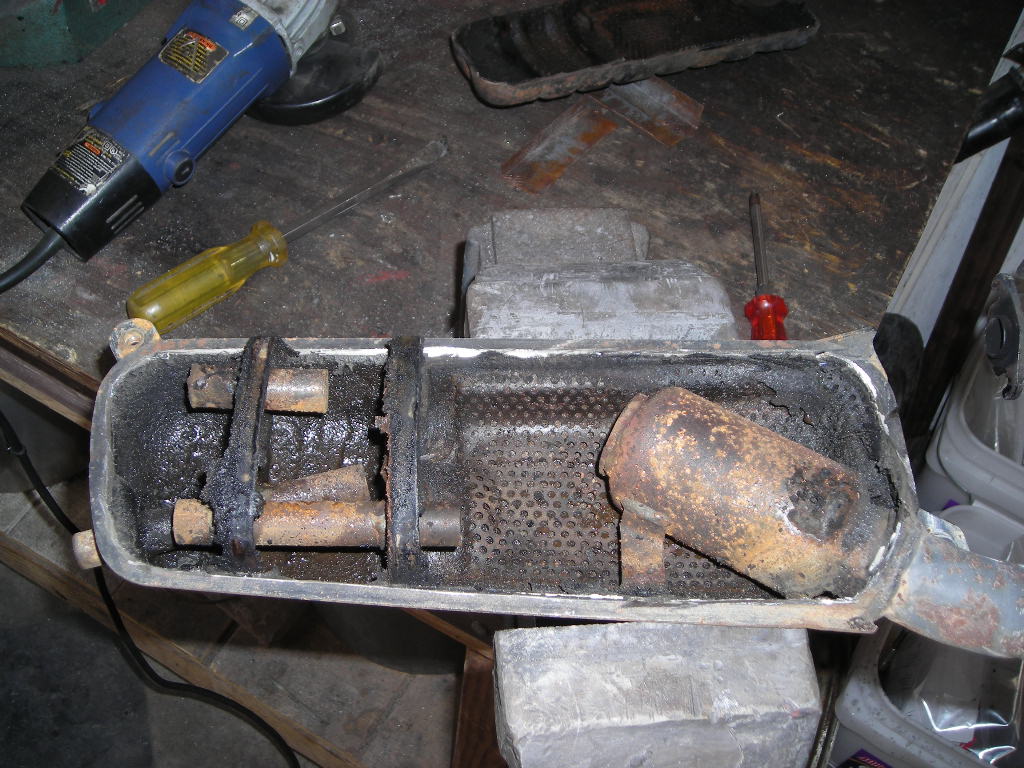

What I meant by drilling out my exhaust was to open it up like so:
(credit: viewtopic.php?f=16&t=6510&start=15)
And replacing one or more of those inner pipes with a larger diameter pipe. Are you saying that I will lose too much back pressure by doing this and thus losing power?
What suggestions does everyone have regarding modifying the stock exhaust until a tuned exhaust is available. I am looking for peak low to mid-range power that will open up when needed. I understand that I am going to be losing some low to midrange power swapping the stock gears out, but I don't think I'll see ANY performance gain using stock gearing with the 48mm BBK, will I?
