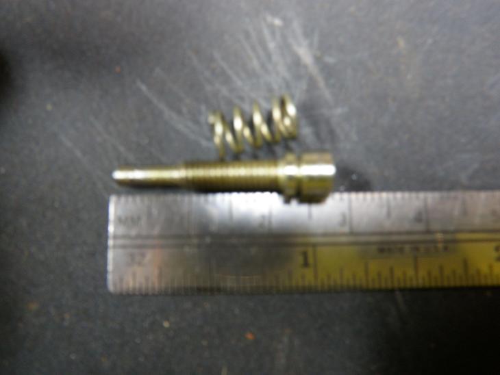

I have a 1984 Gyro. Starts good and runs good, but cannot get it to idle. My throttle stop screw looks like it does not have a long enough tip to it. Almost looks like it is broken off. I get no adjustment by turning it all the way in. Does anyone have a picture of a good throttle stop screw and know if a throttle stop screw from any other carb would work on my 84 Gyro? Thanks

Thanks for the quick reply. I checked since my post and saw it is used on most all models in 1984 and probably more years. Do you now of a good picture so I can tell what mine should look like. The online pictures are not real clear. Looks like it should have a long pointy tip. Like I was saying, I get no adjustment when I turn mine all the way in. Thanks

First of all I have checked the slide. Not the problem. Next, why mess with a cable if it is not the problem. Next, how do I know if the tip is broken off of my adjustment screw, since I am hoping to see a picture of a known good one? I have not seen what a good one looks like or I would rule it out.

Hello: this is out of a pa35k a carburetor off of a 94 elite. don't know if this helps or not.
carb needle.JPG (40.21 KiB) Viewed 7119 times

Re: Idle Set screw (throttle stop)
curtis wrote:First of all I have checked the slide. Not the problem. Next, why mess with a cable if it is not the problem. Next, how do I know if the tip is broken off of my adjustment screw, since I am hoping to see a picture of a known good one? I have not seen what a good one looks like or I would rule it out.
Because *, if it is adjusted too short at the throttle grip then the slide can not go clear to full idle. Crap do you think I make these suggest for some know nothing nitwit like you to argue with me? If the needle don't look broke it isn't. It just has a tapered tip on it. You don't know how to fix it but have the balls to tell me I don't know what I'm talkin' about. *, I hope you never fix it stupid.

Just to up date you all. Dun rite helped me the most. Bear you where wrong, probably like most of the time! Cable had nothing to do with it. Bought a new screw and I fixed a problem that none of you helped me with. Again thanks done right. Bear you were no help at all except to arouse your friends on here about what you think you know and how you like to put down those who you dont know and that might just out smart you.

Post by curtis »
