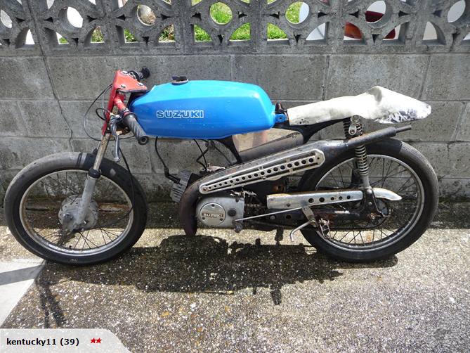

I've PM Taz and I'm waiting for a reply regarding a pulley set, as for a loose definition of a bucket racer: Bucket Racing is a form of motorsport that started up in New Zealand and Australia around the 1980's. It was intended to be the cheapest form of motorsport on offer by using ex-commuter bikes with a maximum size of 150cc stripped of all road-going componentry. This further developed and nowadays 50cc "buckets" are quite common(The name comes from the term 'bucket of sh*t').
As for the track, it hasn't been designed yet; however it is on a airport taxiway so it's pretty flat. I've also been told they only include a couple hairpins, otherwise the geared buckets would destroy us scoots. However it's normally quite tight in that it causes the buckets to slow down whereas the scooters and pit bikes can shoot through at WOT. I'll try and see what I can dig up regarding event promotional material.
Here's an example of a 'bucket':
Re: 6-Hour Endurance Race - Spree Upgrade Tips/Recommendatio
AH, well......the image is now engraved on my brain......much irony that your choice of bucket-bike pic happens to have the label "Kentucky"........the statesiders understand.......a good laugh..... :bowrofl: .......most "mopeds" fit in the same category.......but nowhere does it say that pretty=fast.......... :twisted: .........With airport tarmac to run, and only a couple of hairpins, the struggle will be difficult to keep pace with geared buckets......Is there any purse, or are you racing strictly for bragging rights ?.......thanx for your efforts to satisfy my curiosity......hope this forum will help you along the way......................................... :coolcruise:
