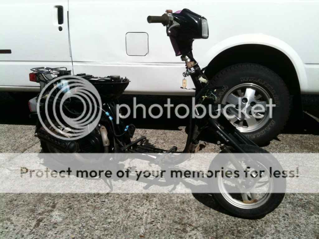

Hey guys, my first post here. I have a 1987 Elite 50 S or SE50 with AF05E stamp on case and 4 bolt reed block. I am having a difficult time making sure I am ordering parts for the right engine. I look up SE50 stuff and the reed blocks are two bolt style. Pulled it apart and there is a GR1 stamp on cylinder head, thinking of upgrading to 44mm kit if I can locate one. Any info on this machine would be appreciated, plan on making a stand up scooter out of this project as the seat and plastisc are toast hench the user name.

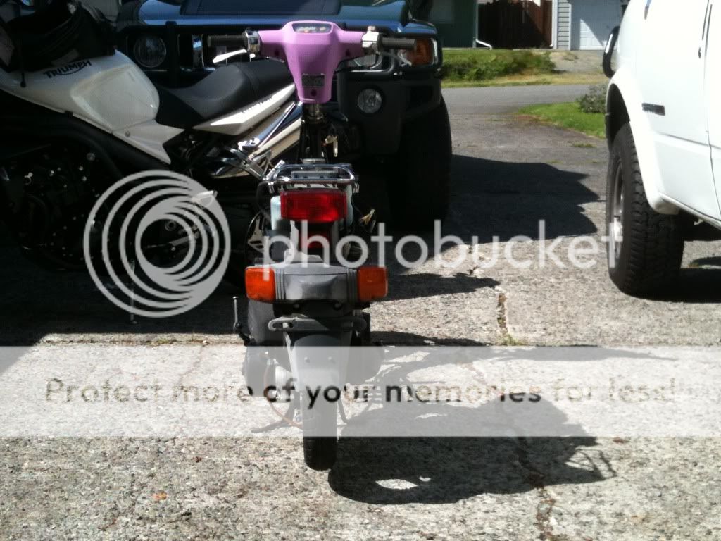

After doing the math I decided to keep this scooter, it's not as bad a basket case as I thought after cleaning it up. I got a spare engine for $75 that runs good enough to get it past State inspection. Going to rebuild the stock motor later on but like the stripped down look so thinking of keeping it as bare bones as possible kind of like a moped or Ruckus. Maybe an aluminum deck or just pegs up front and redo the tanks with moped type seat, not sure yet but it will be spared from the wrath of the cutting torch.
