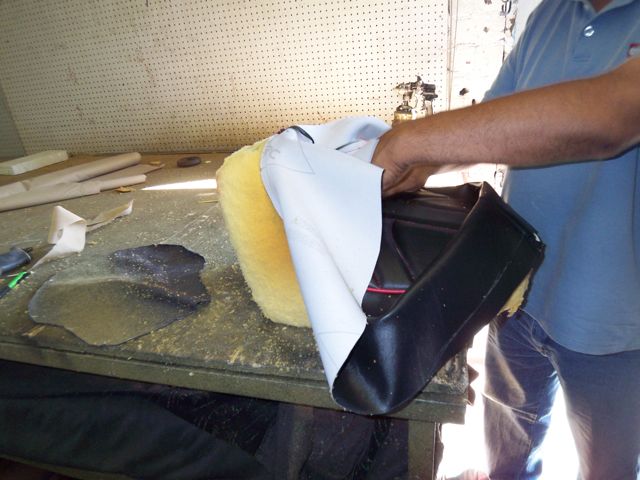

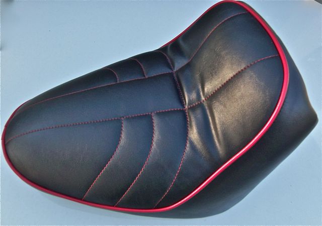

Your seat is done Picked it up this afternoon.
- 100_1330.jpg (54.32 KiB) Viewed 12699 times
- 100_1328.jpg (51.53 KiB) Viewed 12699 times
- 100_1335.jpg (57.13 KiB) Viewed 12699 times

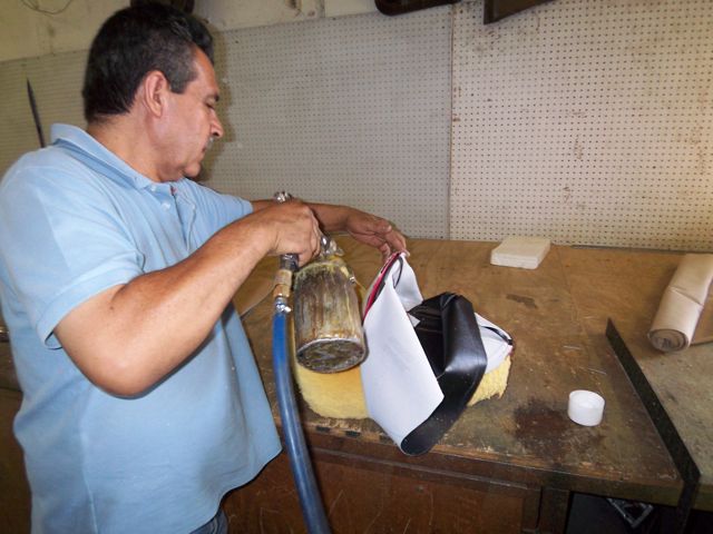

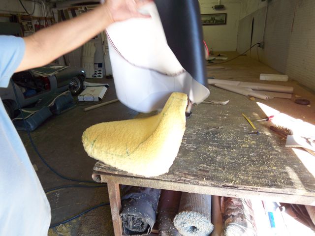

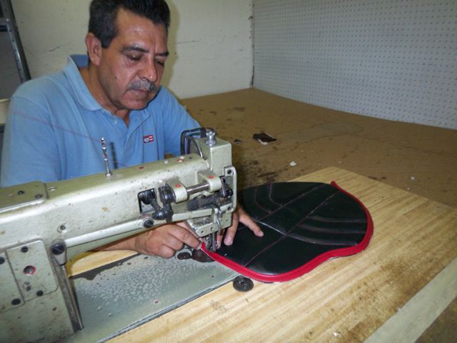

Re: Gyro - general thread
Seat recover cont.
- 100_1332.jpg (55.21 KiB) Viewed 12699 times
- 100_1347.jpg (56.02 KiB) Viewed 12699 times
- 100_1372.jpg (34.14 KiB) Viewed 12699 times
Seat looks great .

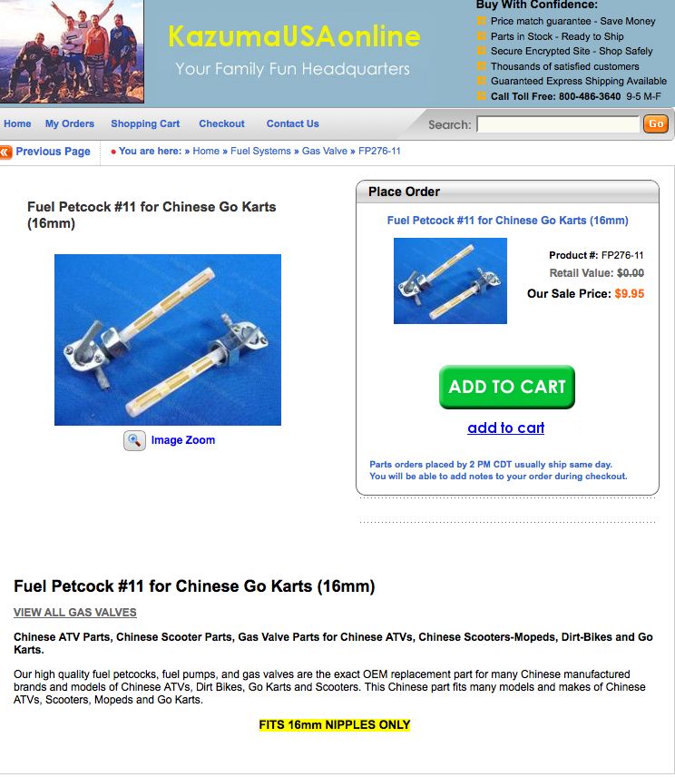

Also ordered China petcock / I guess we will see if it works monday or Tue.
- Same company as below but 800-#
- 16mm petcock ordered .jpg (110.83 KiB) Viewed 12698 times
- 100_1365.jpg (30.58 KiB) Viewed 12698 times
- 100_1364.jpg (39.6 KiB) Viewed 12698 times

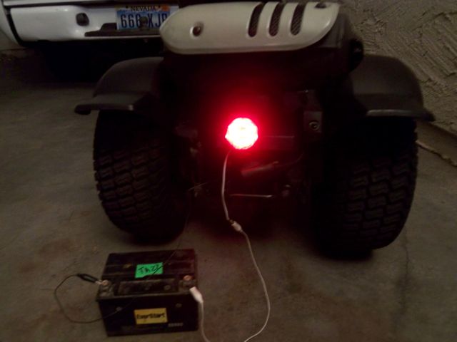

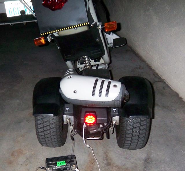

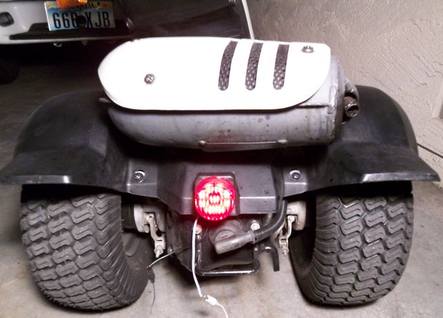

Stupid Decal on back of fender....
On the back of the gyro fender is a stupid decal that does nothing .
But behind it are 2 holes ... Why ?
I,m thinking Honda probably was going to put a light or reflector back there ?
It always bugged me so I had a harbor freight LED kicking around .
Errrrrrrrrrrr drilled a larger hole stuck the LED in / fits perfect .
Haven't wired it up yet but probably black to ground (the bolt that holds the fender on ) then run 1 wire to the running light as I hardly use the brakes .
Check it out .
By the way I haven't given up on the goofy rear fenders ,I just wanted to see if I could build a carb cover
and it kinda came out ok so I stuck it on the industrial gyro and took it for a ride to the bar and had a Myers and coke tall in a chimney glass .
Check it out .
- 100_1388.jpg (59.57 KiB) Viewed 12686 times
- 100_1375.jpg (31.29 KiB) Viewed 12686 times
- 100_1383.jpg (51.84 KiB) Viewed 12686 times

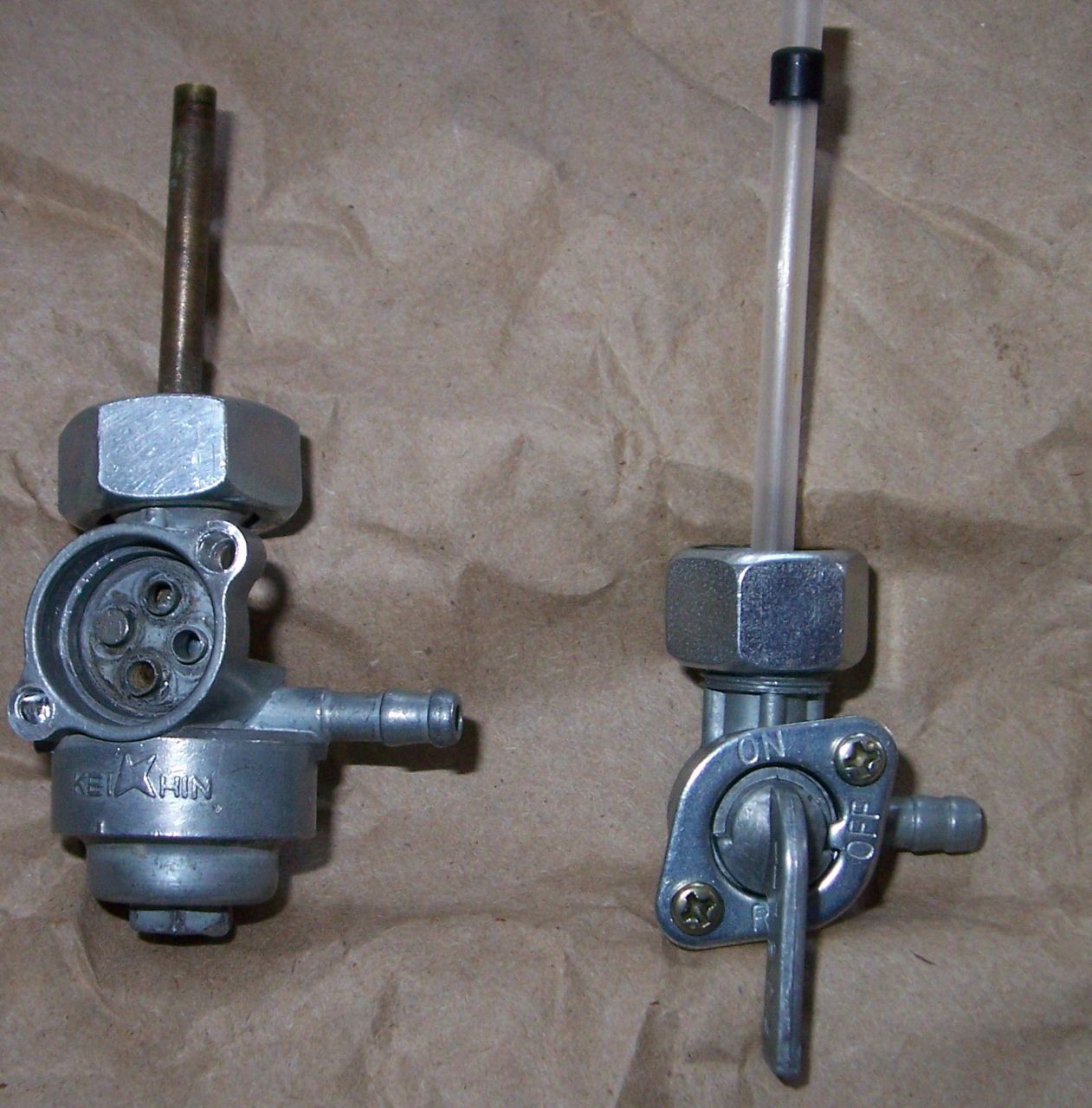

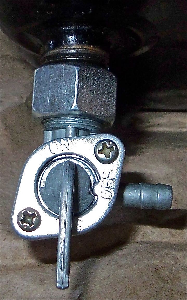

GYRO PETCOCK VS. CHINA PETCOCK
Ordered a China petcock on Thrs. arrived Sat. not bad 3 days .
Finally found a petcock for a Chinese go-cart that looked like it will fit the GYRO .
As you will see in the photos looks close and it does fit the 16mm honda size tank .
1. It has no bowl at the bottom (no biggie )
2. Has a plastic tube for the filter Honda has brass .
3. The outside bolt is smaller than Honda but it is 16mm ID.
4. I was going to replace the China knob w/ the honda but it just a c-hair bigger ( I guess I could try to grind it down )
5. Looking forward to many hours / min. of use w/China petcock (I am sure it will not last 25 years like a honda one )
So if your really stuck for a petcock I hope this might help you out . I ordered it from BuyATVsOnline.com ph.618-529-80000
Cost $9.95 plus $7.95 shipping $17.90 total .
- 100_2136.jpg (162.85 KiB) Viewed 12671 times
- 100_2137.jpg (221.44 KiB) Viewed 12671 times
- 100_2138.jpg (135.76 KiB) Viewed 12671 times

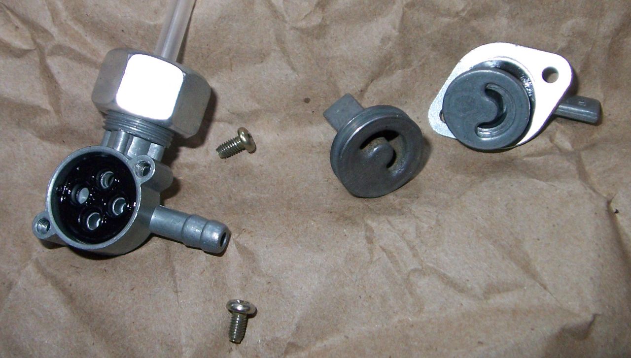

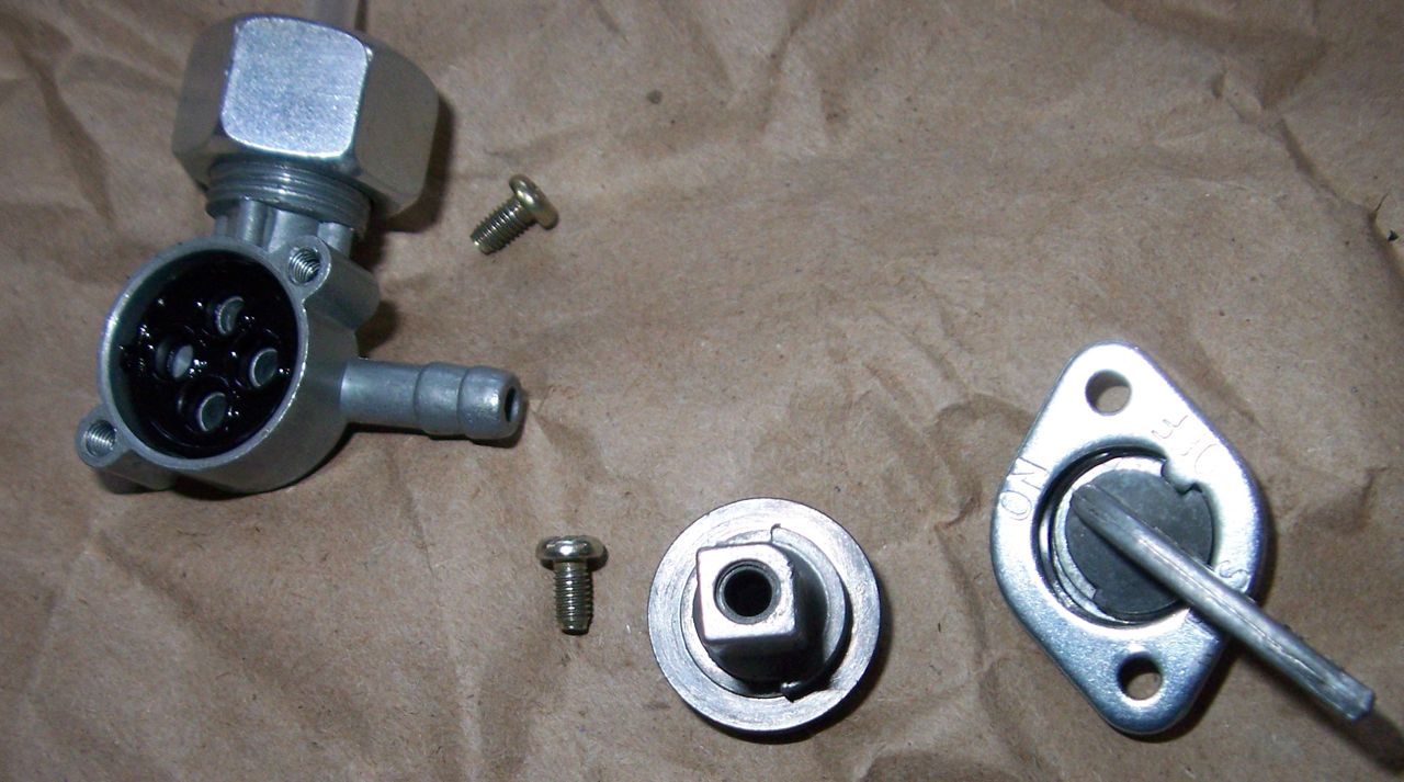

petcock
- Honda just a little bit bigger on spigot so not inter-changeable
- 100_2139.jpg (138.8 KiB) Viewed 12671 times
- Fits on Honda tank
- 100_2135.jpg (165.17 KiB) Viewed 12671 times
- COST
- 100_2143.jpg (159.74 KiB) Viewed 12671 times
