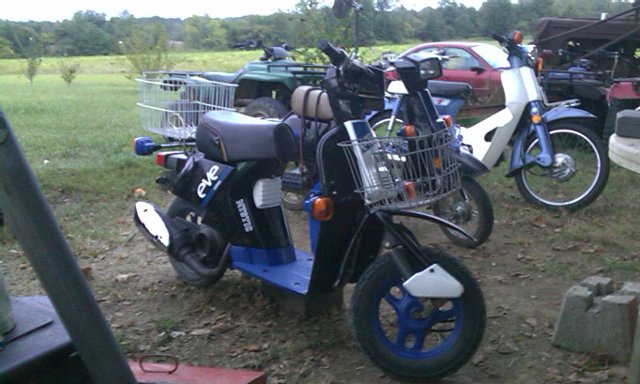

dont wanna take it off. oh yea i took this pic for you swimmingfree, d*** chickens
