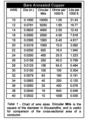

Probabaly best to measure the wire you have, and look up the gauge. Wire gauge and a resistivity table should get you in the ballpark. Honda has a pretty high variablity allowed for resistance. Also, 600-900 ohms points to thin wire, and a lot of turns required.
For the spark exciter coil, you are looking at 300-400v. I figure you probably know care will go along that winding your coil. There is thin mylar (and other base materials) tape used for insulating taps and layers of windings. Std electrical tape is likely too thick to allow the correct number of turns to fit.

mousewheels wrote:Probabaly best to measure the wire you have, and look up the gauge. Wire gauge and a resistivity table should get you in the ballpark. Honda has a pretty high variablity allowed for resistance. Also, 600-900 ohms points to thin wire, and a lot of turns required.
I apologize for reviving this thread but I brought the scooter into my basement from being stored for winter. I still am intending on re-winding the exciter coil. Are you saying that they used insulating material between windings on the exciter coil? Why when the wire is already enamel coated? I was planning on winding with similar sized enamel (magnet) wire and then dipping the whole thing in Helmsman Spar Urethane. A lot of people use that for coating coils including myself when I built my Tesla coil.
Also, your chart is for annealed copper wire, not enamel coated wire. I assume adding an enamel coating with change the OD of the wire thus making that chart not entirely accurate? I will see if I can find an enamel coated wire chart.
Yes the wire table is bare copper. Just a rough approximation to the ohms/foot part to get an idea of gauge and how many feet Honda had on there... Agreed, OD will be different for enameled wire.
