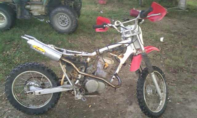

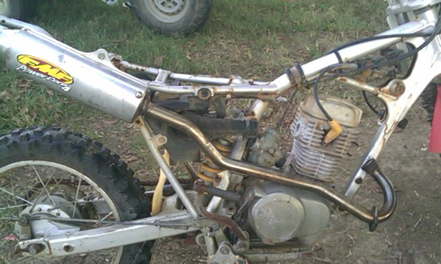

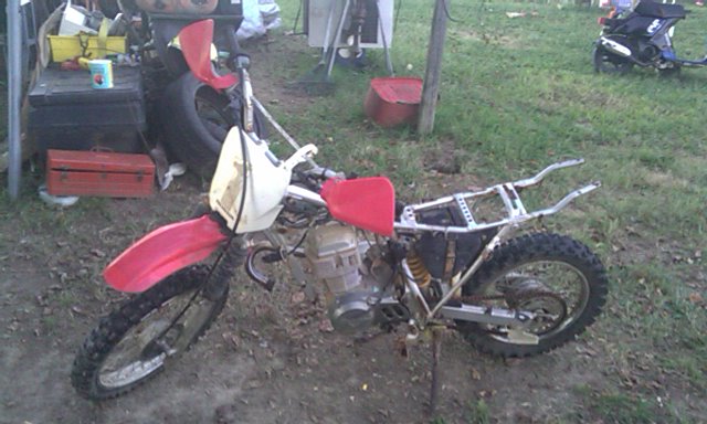

My ucle called me up today and asked me to come over. He traded for some junk he wanted me to come take a look at that I may be interested in
The xr80r was complete except for the engine hanger plate and an exhaust luckily I have a pipe and a hanger plate
the other is some kind of dune buggy someone made out of a small honda 4 wheeler I am thinking a 90cc or 125 not quite for sure both have seen better days. All the plastics were in pretty good shape for the xr80 even had the key so i figure I will get it running and back together first. it wasnt rolling when i got it so i took the front wheel off and hte brake pads had rusted to the hub and came off so scraped all that out and got it in nuetral
didnt get the head off before it got dark but hopefully the cylinder and piston are in good shape, will know tomorrow. If they are this thing will be a breeze to fix

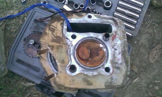

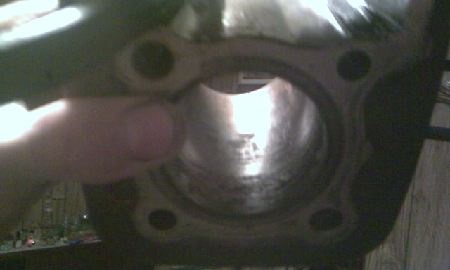

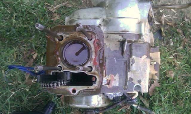

tore into it this evening and it took me forever to get the camchain off i had to take a wrench and loosen the bolts that hold the sprocket to the shaft being careful not to drop them in the case and pull the camshaft out then the sprocket with the bolts still in it, it was locked up tight as a drum no movement of the camchain or the flywheel. As I suspected since the exhaust had been left off water had leaked down and the exhaust valve was open so water sat on the piston off and on for a year and rusted up bad. let it sit with oil for a bit then tapped on it with the rubber end of a hammer and another hammer to hit it with but it still took a while. the piston and cylinder is in better shape than I expected and the rings appear to be good. gotta hone the cylinder to get all the rust off and brush the piston, combustion chamber, and valves with a wire brush on the bench grinder. make a base gasket of course. maybe i can get it all done tomorrow and back together. so far so good

Yea that bore looks pitted by the rust
How much can you hone it out?
Bigger bore = power =
Good work so far
Good work so far
Re: New Project
dont know if its pitted or not, what you see in the picture is the rust buildup I gotta go borrow a honer today and see what I can do to it. I am going to try and reuse the piston and rings so i will hone it just enough to make it smooth again.
