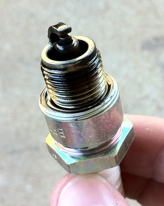

So I went out of town for the weekend with two decently well running spree's, an '84 and an '85. I came home to two dead spree's.
I had trouble throughout the summer getting them to start consistently unless they were being ridden everyday. To remedy it usually if they wouldn't start I would unscrew the idle screw, they would start, and then I would dial it back in during the ride. Well my girlfriend attempted this method while I was gone and unscrewed the air/fuel, so much so that they fell out on both scooters during the ride.
So needless to say they both stopped running. Now I'm trying to get them up and going again. I don't think she did much damage. Replaced the screws, cleaned out both carbs. They both sound as though they want to turn over, cranking, cranking cranking, but neither will start.
I assume it's either the fuel or spark. The fuel wasn't an issue before, both bystarter's have been replaced. So my guess is spark?
Below is a picture of one of the plugs. It looks awfully oily to me but I feel like two strokes tend to get that way. Does it look fouled? If so, what is the proper way of cleaning the oil out of where the plug is seated? Because I took a second plug, threaded it, and then pulled it out and it was covered in oil as well.

check compression, with the screws out she may have run them lean

Crank the engine without the plug see if some oil/fuel comes out. She may have pumped the cylinder full trying to start it. If so, keep cranking until most of it is out. Spray that plug with some carb cleaner wait until it drys and reinstall.

Crank with the vacuum line off for the petcock and hold it WOT.martynkim wrote:Crank the engine without the plug see if some oil/fuel comes out. She may have pumped the cylinder full trying to start it. If so, keep cranking until most of it is out. Spray that plug with some carb cleaner wait until it drys and reinstall.

Finally got a hold of a compression tester today. The '84 put out 90 lbs, the '85 put out 80 lbs. Thoughts?

manual shows 114psi, so..CMason wrote:Finally got a hold of a compression tester today. The '84 put out 90 lbs, the '85 put out 80 lbs. Thoughts?

The 90 PSI on should start, the 80 PSI one is iffy at best and may never fire up.CMason wrote:Finally got a hold of a compression tester today. The '84 put out 90 lbs, the '85 put out 80 lbs. Thoughts?
Cleaning plug is problematic at best a new plug my let the 90 PSI motor run.
In either case both motors need a rebuild.

The top end needs rebuild. Piston and jug.
Re: Help, Girlfriend PWNED My Scooters
You can get away with just a hone job if the cylinder wall is not scratched to bad. The way to tell if the scratches are so bad you need an overbore and an oversized piston and rings is, if you can catch your finger nail in any scratch, then you must bore the cylinder and buy an oversized piston and rings.

Also, spec the cylinder. It will only take so many hone jobs before it needs to be bored over.Bear45-70 wrote:You can get away with just a hone job if the cylinder wall is not scratched to bad. The way to tell if the scratches are so bad you need an overbore and an oversized piston and rings is, if you can catch your finger nail in any scratch, then you must bore the cylinder and buy an oversized piston and rings.
Pull the spark plug and dump a little oil in the cylinder then rotate the engine. Now try starting it. Sometimes a little oil will raise the compression enough to get the engine running for a short time.
