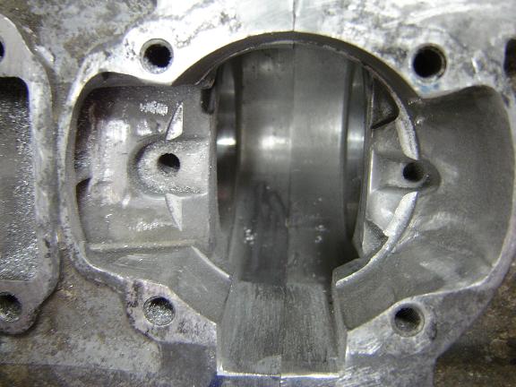

Hej guys!! It's been a while! :blah:
I bought a aprilia RS125 exhaust the other day! :D
I will modify it to fit on my stroker engine! ;)
The engine is allmost finisched, the only thing to do is the reedcage/intake.
Koert :coolcruise:
modified cases, transferports wil be sandblasted :D
