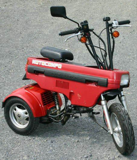

Here's a custom Motocompo found on the 'net. Short write up is at this link

that is one awesome scooter made even more awesome
- Posts: 3676
- Location: Iowa, USA
Re: Gyro - general thread
Two awesome scooters.gyromaniac wrote:that is one awesome scooter made even more awesome

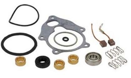

Ive got a gyro s i picked up on a super deal and cleaned it
Up and its
Looking boss but it needs a starter can any one help me out i would be super great and will pay good money for one thank you guys
Up and its

Beyond locating another Gyro starter, here's other options. I prefer the rebuild path
-- Rebuild --
If your armature is failed, it may be replaced with one from Honda models listed below. Spree armature's can work too. But be careful with the Spree, I have received a starter starter with a different number of teeth on the shaft. Then get new brushes/springs, oil seal and bearings which fit the Gyro/Spree/Aero/Elite (AF05's only) in a starter rebuild kit for a Suzuki LT-80 starter (see eBay, about $23). There will be serveral parts in the LT80 kit you will not use.
LT-80 starter rebuild kit:

-- Rebuild --

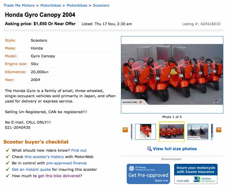

Honda Gyro Canopys for sale .
But the shipping will kill you ...
