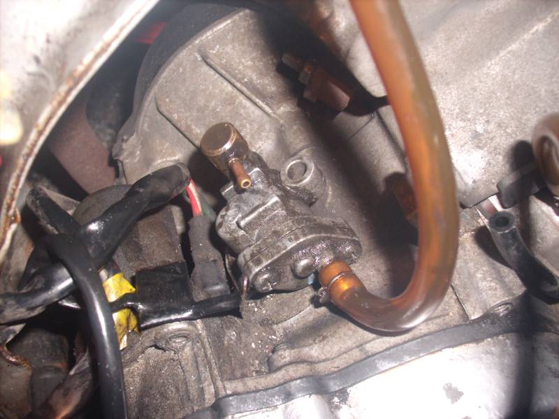

Trying to get my Aero back on the road again. The oil pump has wiggled loose and what originally secured it has been eaten by the road.
I have had some help from some very nice forum members and obtained the bolt and nut and what i think is the oil pump set plate
but i cant quite figure out how it holds it in place. cant find any clear pictures in the service manual. heres some pics of what i got going on. my pump, the bolt i got from mystic, and the plate from brandsnscars. thanks again guys.

I think that plate is for the af16, not sure what, if any difference there is between the 2
here is the diagrahm showing the set plate, the one you have looks to be like the one in the picture. the bolt i sent you holds the pump to the crankcase and the other spot it bolts is to the top bolt that holds the starter on

I'm pretty sure the set plates work with either block.
I think you need to rotate the pump 90 degrees to the left. Then the L-shaped "tongue" that's in the middle of your palm just sits atop the pump, pressing it down. There are bolt-holes in 2 planes, one of which uses the hex bolt and nut in the vertical plane. The thin nut slides into the slot cast into the engine crankcase. The other bolt-hole uses one of the starter bolts(?) or one right near it in the horizontal plane. That leaves the tang with the "split" hole pointing West to cradle the pump's cable.

then again you have an 85 aero which is different from 86 and 87, that set plate is for either 86-87 aero or af16 not sure if it will fit. the plate for the 85 is different since the 85 pump only has one mixture ratio as opposed to later models that had the cable adjusted mixture. maybe it will bolt on there if not you may have to make something if the bolt itself wont hold it down

ok looking at the diagram it seems pretty clear i have the 86/87 pump set plate
which turns out to be different than the 85 crankcase plate
so i guess i need to get or rig that that set plate dang.

there is a bolt that goes through that plate then through the shroud that covers the top end.

Nice pics finally can se the piece i'm missing. i know where the plate bolts to the shroud
but i'm not sure how it holds the oil pump down. doesnt seem to bolt on.

it only hase one bolt (through the shroud). the plate just pushes on the pump to hold it in place.

okay i think i see how it might go. i see a groove that looks like a piece can slide into it
no worries wheels i appreciate the help cant win em all
ok i think i have rigged it up to where i think it might be all right. had to
remove the hose that goes from the oil pump to the crankcase to get it in secure.
reattached the hose. is there some trick to bleeding the air out before i start it?

Ok seems to be doing the job for now. back on the road, no bystarter but after the first start, its starting right up. prob keep my eye out for one eventually and the right oil plate. i'll post a pic later of my hack job. thanks for all the help on this one, stupid little thing but it really had me stumped.
