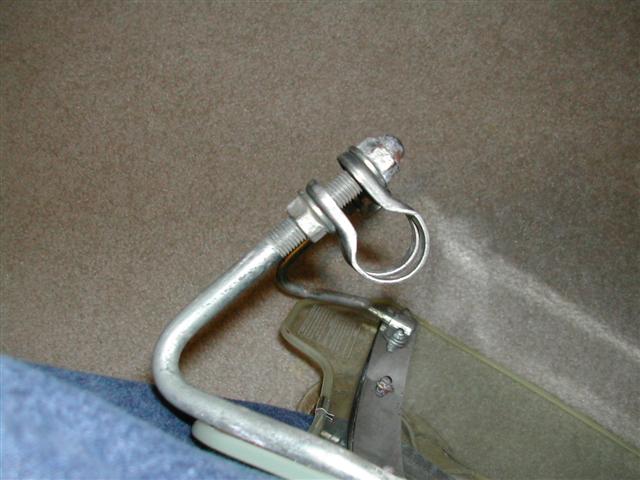

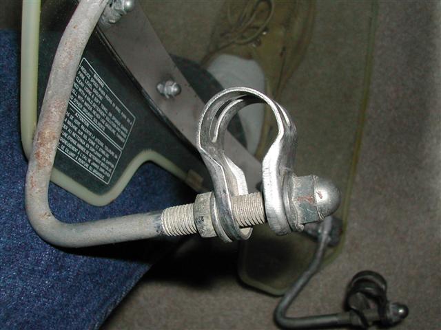

Ok Mystic, I'm back and was able to take a picture of the bracket on the windshield... does this look like yours?
If the image doesn't appear than uploading isn't as easy as I thought!
spree screen 003 (Small).jpg (45.91 KiB) Viewed 6650 times
spree screen 001 (Small).jpg (47.58 KiB) Viewed 6650 times

gotcha. loosen the handlebar controls and slide them toward the end to open up enough space to put those clamps around the handle bars then tighten. willl be easier to take them off the shield then put the shield on once you have the brackets installed

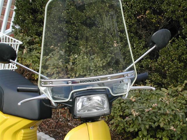

Got the windshield installed... was able to get all new hardware at Fastenal for $4. Used Novus plastic polish from the Harley dealership to buff out scratches. Stuff works great!
Thanks for the help and advice.
chrome 013 (Small).jpg (78.9 KiB) Viewed 6612 times
chrome 001 (Small).jpg (82.15 KiB) Viewed 6612 times

a small bit of advice, you might want to brush some clear acrylic on the metal parts of the shield if exposed to high humidity or rain it will develop rust spots easily :D
