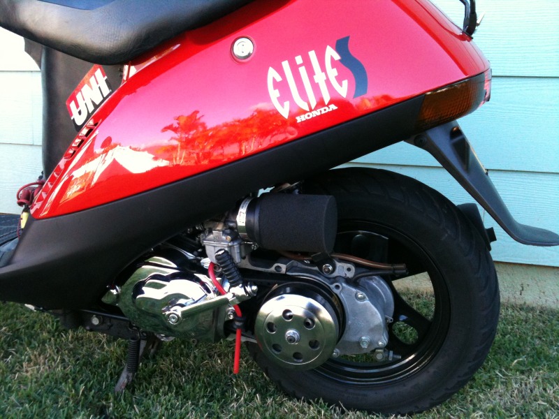

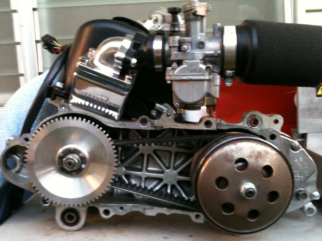

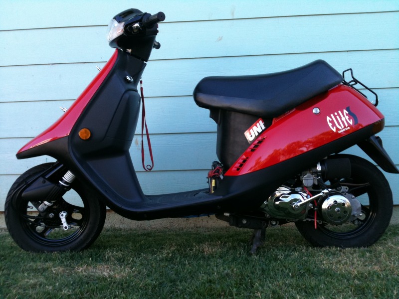

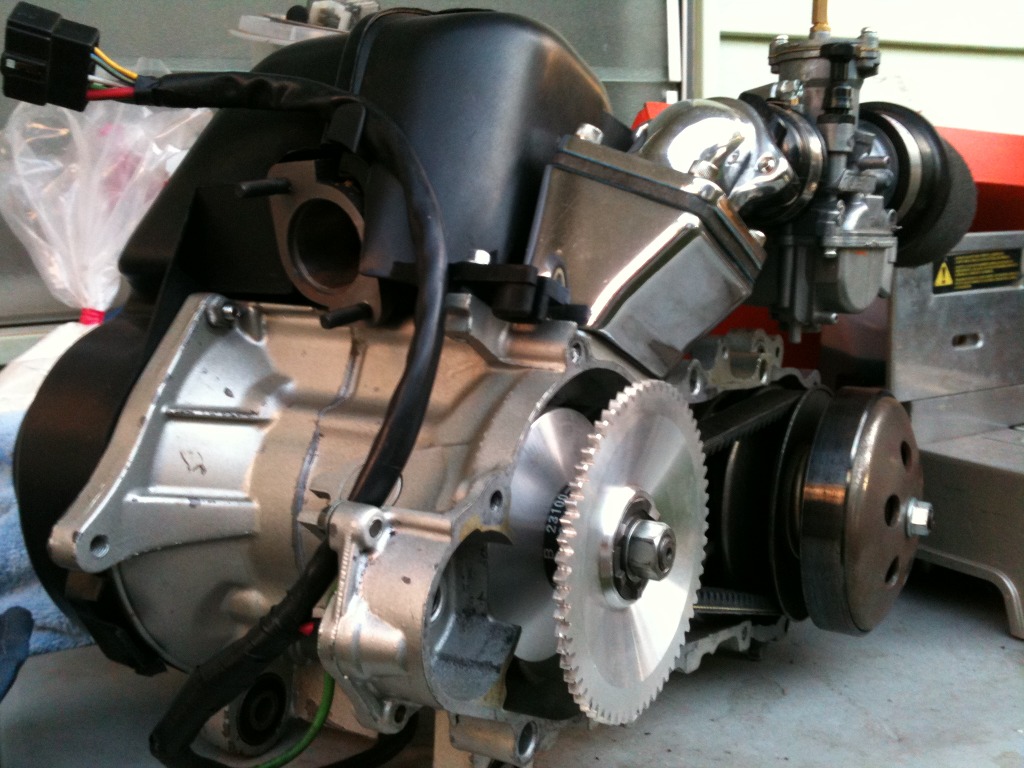

Post by arnada »
Specs?
Cool Al-you-minnie-yum pulley. I've been thinking of getting one but does it help anything? Does create any clearance issues with the kickstart?
That's an outrageously big intake. I like the idea of supporting the carb from below. Any tips?
Dish, Dawg, Dish!!
arnada
Posts: 66
Joined: Sat Dec 11, 2010 5:09 am
Location: waianae hawaii
Post by arnada »
56 taida bore, 52.7 taida crank, keli pully, sef ramp, polini gold center spring, malossi clutch and bell, pop intake, zx trans, 6.3 gears, 28 keihin, aluminum driveface, 3 post racing stator. for sale 1000 firm, everything new, and never started. sorry cant tell you if pully makes a difference and carb does not have a support but THAT IS a great idea! btw its @ 130ccs :)
