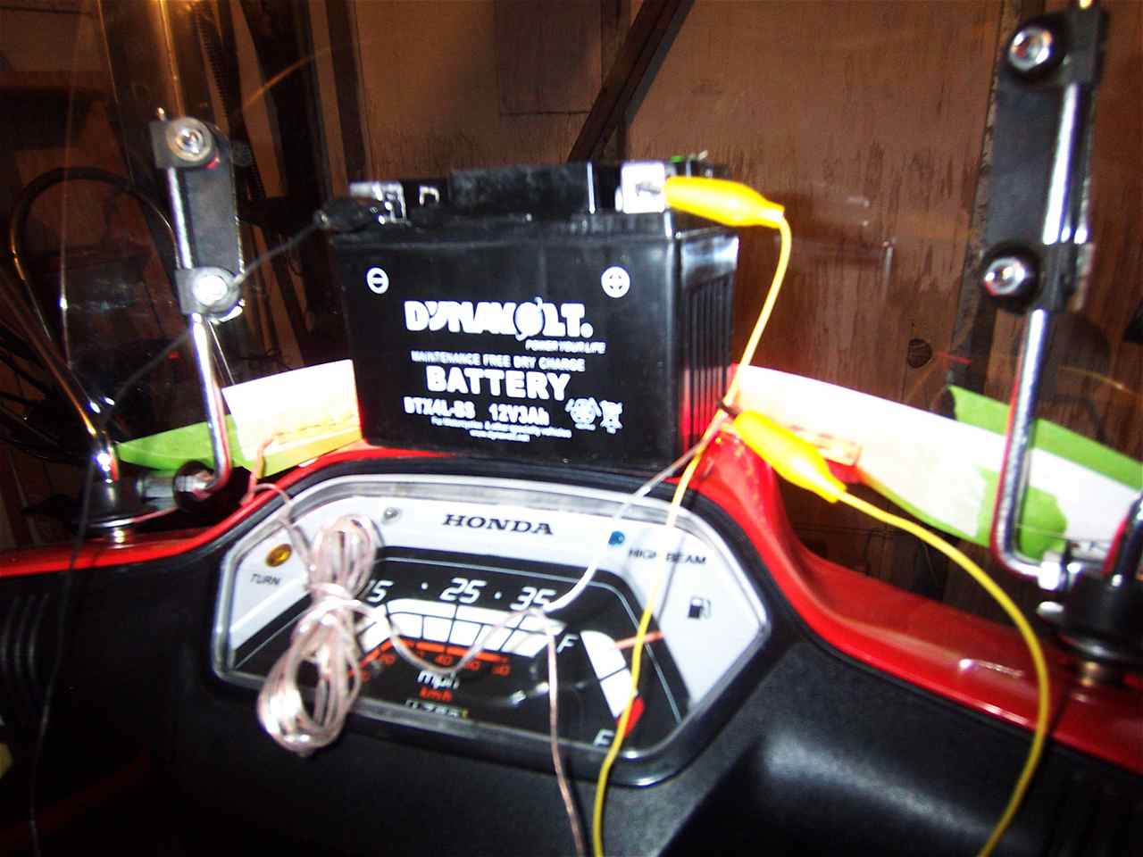

Most of the stuff will be ground to the bike , so if you clip on to something metal you should be OK for your negative then connect a test wire to the positive side of the battery
clip it to one side of the horn then ouch the other side with the negitive test wire the horn should beep ( careful it will vibrate in your hand ) or you could just touch the anything metal on the bike and it should beep .

- test battery and test wires

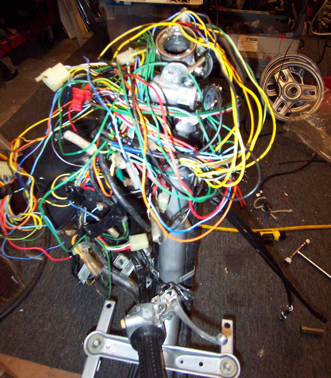

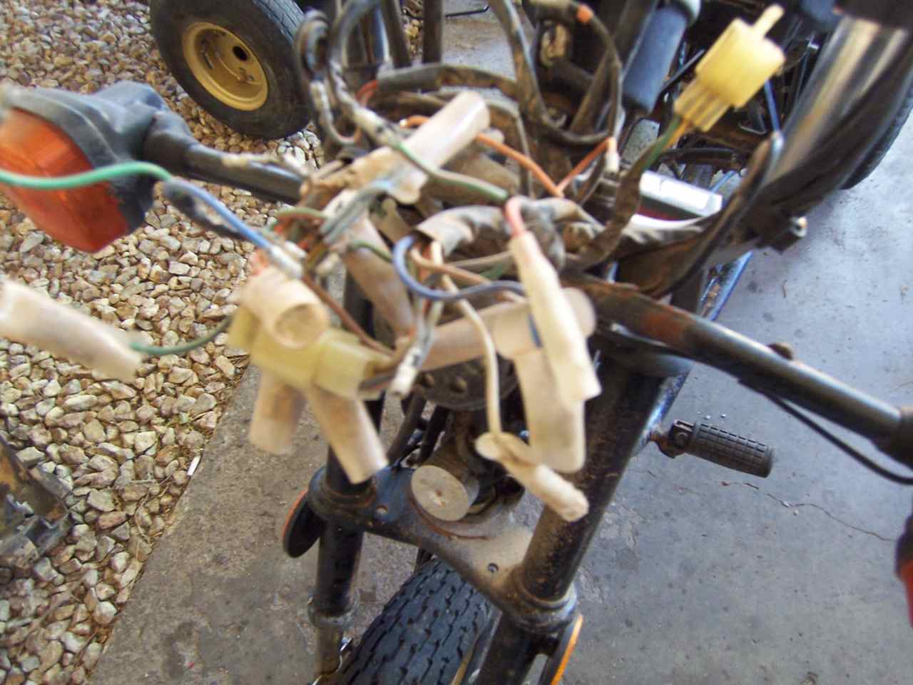

- just think of one wire at a time
- 100_6672.jpg (97.34 KiB) Viewed 3809 times
- This is just a bunch of wires I stuck on a bike for a photo ... Just be patient one wire at a time ...
