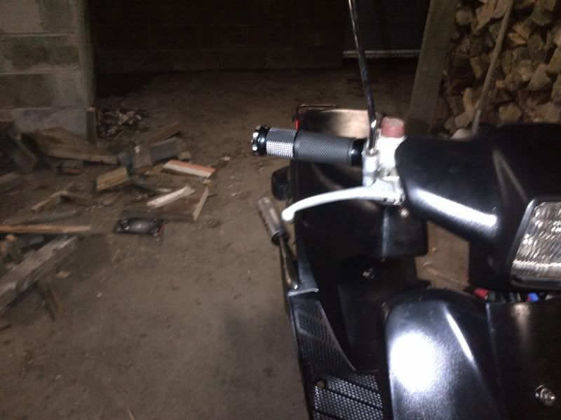

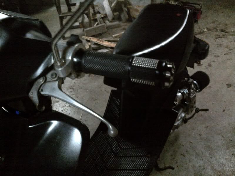

Got a minor detail completed. new grips! My friend had them for his buel blast, which they came with his aftermarket brake leavers. Huge improvement over the old ones for sure:
