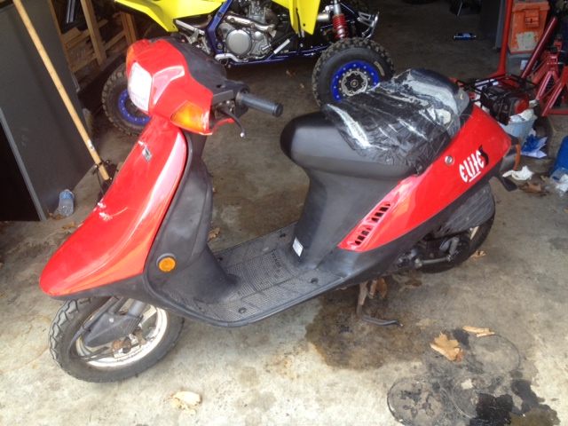

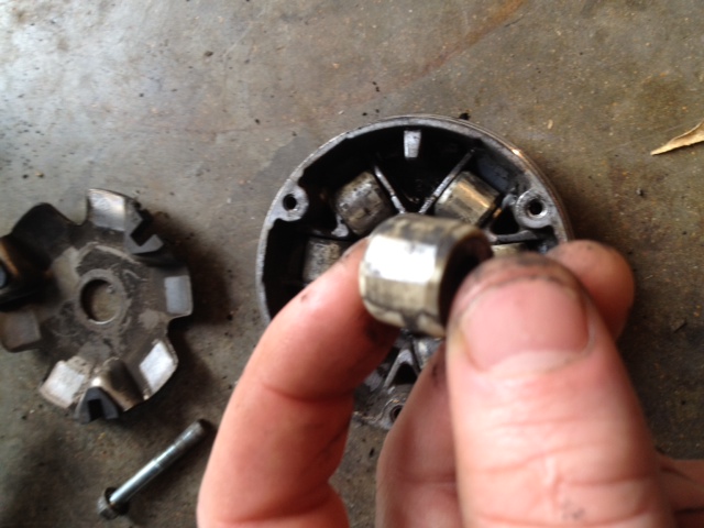

Just picked up my first elite on sunday. Im already addicted and havent started yet :smile: I de-restricted it, waiting to pick up a bigger main jet tomorrow. Right now top speed is about 35, but it has a 68 main so I have not been riding it much. Keli variator (9g rollers) is in the mail from Daywot, should be here wednesday ish. Im hoping to break 40 with the variator and bigger jet. One question I have; will just the variator and rollers make a difference with the stock ramp plate? The stock rollers are shot and have 2-3 flat spots on each one. Here are a couple pics. It needs some tlc, but I picked it up for 300$ so no complaints. Im semi-new to the scooter world so any help/info is appreciated. Thanks
The front piece is cracked pretty bad

congrats on your new (to you) ride. =) :thumbwink:
yes a new variator and rollers will make a difference, even with the stock ramp plate.
what is your budget like? (no need to answer, just need to think about it)
you can find a replacement front piece on ebay or perhaps another member might have one (just post on the for sale/wanted section)
If you want to do the work yourself, there are repair threads on this forum that would give you some suggestions and techniques that might be useful to you.

Might be worth a good look at the belt if the rollers are that worn. It's a good time to replace it while you're in there changing out the variator. Specs are in the service manual.

So far I love it. Pulled the variator off today to check out the rollers, two of them were sideways and out of place, holding the ramp plate open. Fixed that and now it cruises easy at 45. Got to 53ish on GPS on flat ground. Its a dog going up big hills though.

Got the variator and rollers in the Elite, wow what a difference! I did that, and put a 85 main jet in (had a 68) and top speed went from about 35 to 45. It will get close to 47mph on a downhill.
