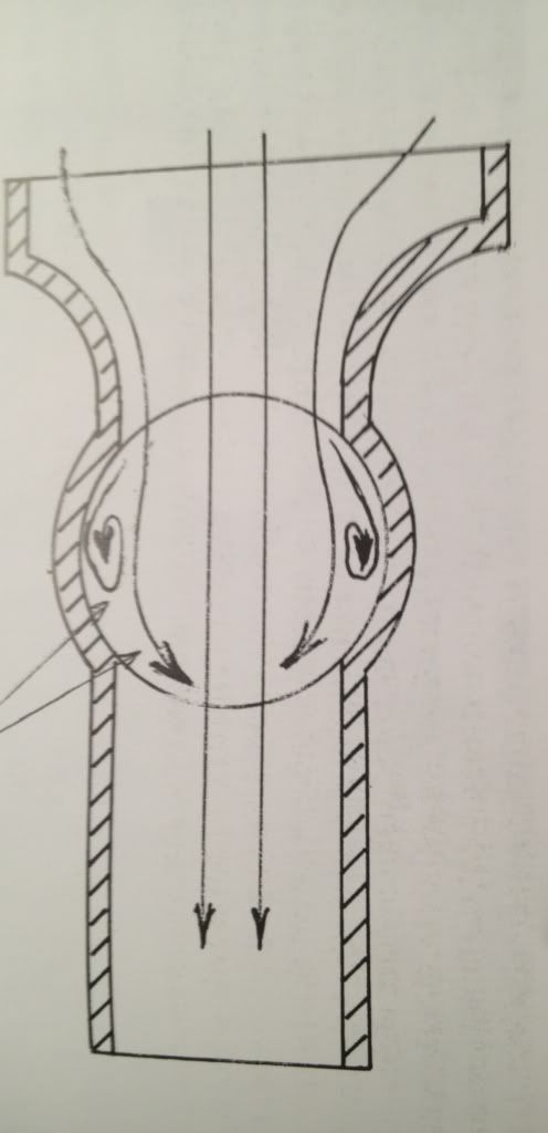

A picture is worth a thousand words. But I dont have a picture.
On the a round slide carb. The bore where the slide goes up and down is round to accommodate the round slide(I know you know this im just trying to paint the picture) , so picture when the slide is open it leaves a half moon cutout on either side of the venturi. The half moon divets cause the air flow to eddy which ends up limiting air flow.

Found a pic Image
