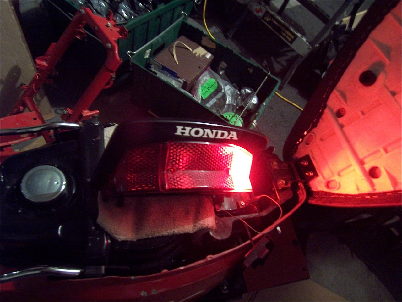

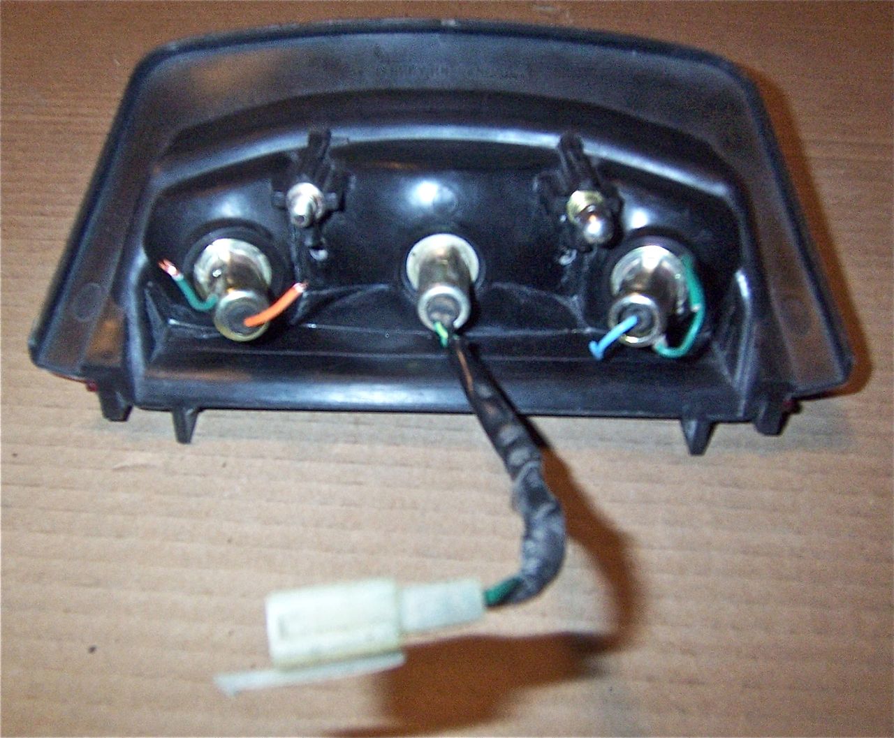

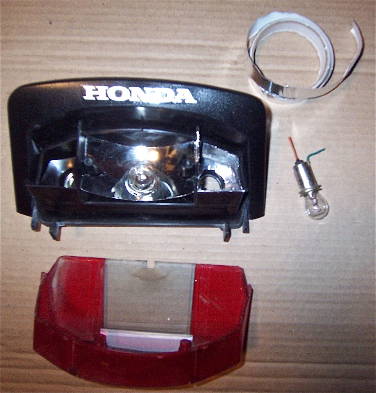

I am in the process of re-building my last Gyro and thought why not take advantage of the rear taillight .
it has a place where the turn signals would go so why not use it ?
I got some old taillight bases ,then drilled out the holes where honda probably was going to put the turn signals .
Then I used some aluminum tape on the inside for reflection .
Hooked up some test wires .... Done !
I hope to not use the amber turn signals and just use these and the wiring is already there will just use the stock wires & connectors .
Or if it looks too goofy hook the left & right up to the brake light .
This was made for turn signals There is already a divider to stop light leaks . and you can see where  to drill the holes. You can see on the right  side where I put the tape .
Rear of Tail light w/ turn signal bases
Right tail light
Right tail light
Re: Gyro - general thread
That's super 66Six :thumbsup: I've long looked at the US taliight assembly and noted we got everything but the Red and Amber lenses that JDM RoadFoxes have. US back plasitc has had filled in holes for the turn signals, JDM parts have openings for the turn signal lamps.

Nice touch! Here is image of OEM set-up...
Thanks Guys !
You have given me an idea I need to find a Road Fox Tail light lens , How hard can that be ?

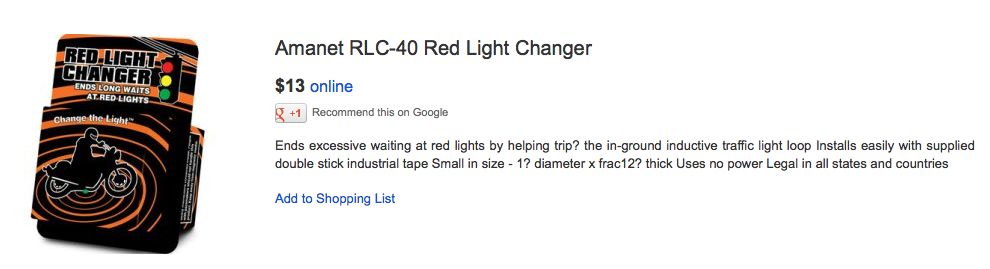

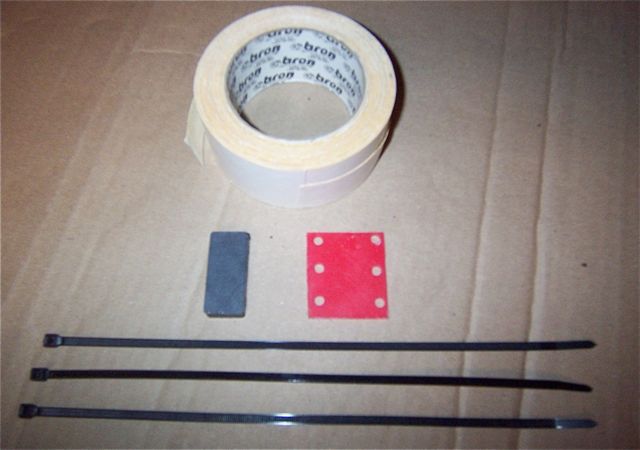

RED LIGHT CHANGER I always get stuck at red lights and with a scoot it's not enough metal and weight to trigger the signal lights .
I was in a bike shop and noticed a RED LIGHT CHANGER for around $ 20.00 so I took a look at it , it was just a magnet in a fancy box .
So I thought make my own and with the money I save I could go to the bar and get messed up then not worry about getting stopped at a red light .
I just made it tonight then went to the bar and sure enough the light did change was it coincidence ?
I don't know ?
What a RIP - OFF .
What a RIP - OFF .
Screen shot 2012-03-23 at 7.58.19 AM.png (116.05 KiB) Viewed 7697 times

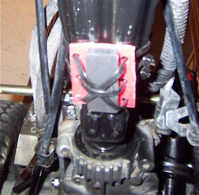

A magnet  / a hunk of plastic with some holes drilled in it / double sided tape / zip ties / DONE !
get a bigger magnet...then you will never get nails in your tires... :2thumbs:
