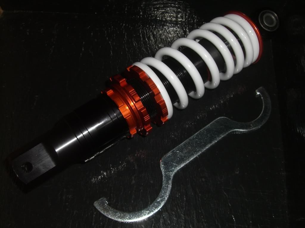

Found this one on ebay - says it's rebuildable, is adjustable in shock overall length, & has infinite spring preload adjustment (not ramped adjustment)
It's a little bit more than the daywot basic shock tho ($75 vs $45)
May be good as my phase 1 upgrade
~edit~ He emailed back & said this one IS rebuildable ! :)
Uses 40cc of oil
DId not say what the weight was - just that it was Bilstein oil
http://www.ebay.com/itm/330687422580?ss ... 1423.l2649

Will this shock fit my 01 Elite SA50 with the stock air box?
http://tinyurl.com/6pjdgha
Anybody here ridden this shock ?
What's your opinion?
Altho this one looks better made & about the same amount of money ....but it's out of stock :-(
http://www.racingplanetusa.com/shock-ab ... c246dfbf47
Altho this one looks even better, comes in 285mm length, has rebound adjustment ...but is more money :(
Maybe I should save up until I can afford it ?
Wonder how often I gotta check the air pressure...gonna be a pain to get to the valve - rear bodywork
....maybe just removing the seat storage 'bucket" would allow access to valve
