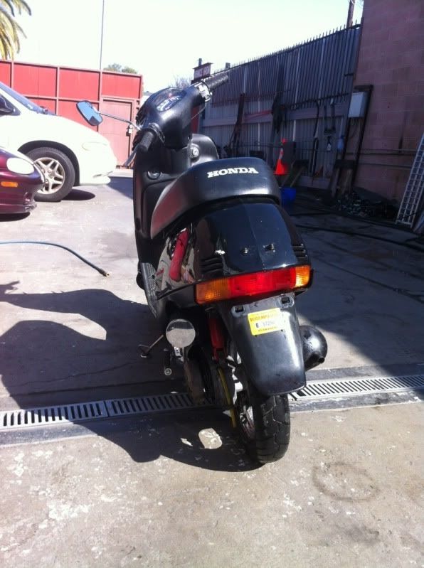

I did not build this bike nor did the guy I bought it from. I do not take credit for building anything on this bike. I would like to give credit where credit is due. Only credit I want is getting a cherry bike instead of some one who might not love it as much as I do.lol
Bike is from Oahu same island as me also so it's even more cool lol. Lmao.

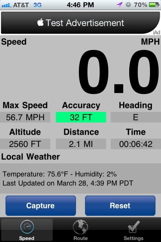

And the iPhone app is pretty cool

Sweet ride... How did you find that sweet thing?

Ty ... Found em all on CL

what app is that?

Sorry called max speed iPhone app and was free. That it was cool to take notes on everything to help learn to tune better... Need the other one for the power band

these rear panels... what honda do they come off of
