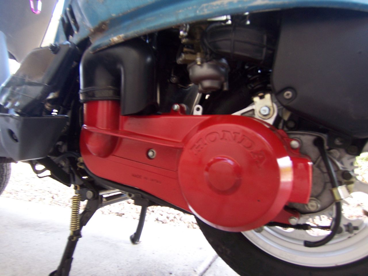

Just got done with spree motor! Just look at it!

I will do a compression test later today hopfully and post it up here. i didnt port out the exhaust nearly as much as i did the intake manafold, i honed a little it but mostly de-carbonizing and beveling the edges. For some reason i didnt even think about the cooling fan :l more stuff to add to the list, holw do you test a magneto? i have done it before a few years ago but i dont remeber exactly how.
Also, i decided to do the honda in black, i will paint it when i get clear-coat for the case.
Re: Just got done with spree motor! Just look at it!
Wasted your time then. The exhaust has to be able to handle the increased intake air flow or there will be no increase.NateHimself36 wrote:I will do a compression test later today hopfully and post it up here. i didnt port out the exhaust nearly as much as i did the intake manafold, i honed a little it but mostly de-carbonizing and beveling the edges. For some reason i didnt even think about the cooling fan :l more stuff to add to the list, holw do you test a magneto? i have done it before a few years ago but i dont remeber exactly how.
These engine do NOT have a magneto, the have a CDI (Capacitive Discharge Ignition). Testing procedure is to be found in the service manual.

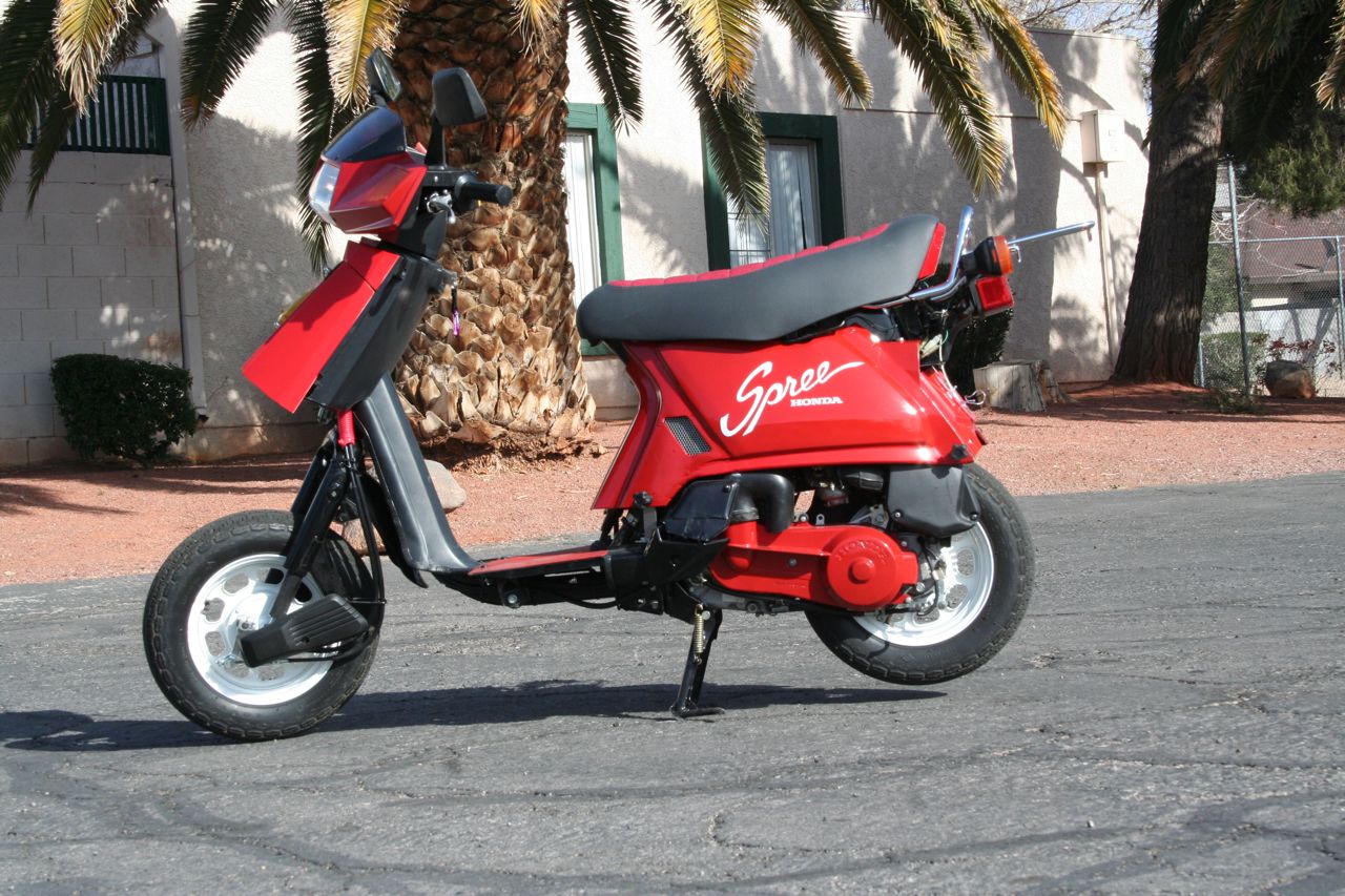

A red engine makes my bike go faster .
Who knew ?
Who knew ?

motor looks nice:) and i did port it out just not ALOT. spent some time in there with a chainsaw file and a dremel. either way i was just killing time until my parts got there. So, the flywheel and magnet arent part of a magneto? i always thought thats what it was called.
Download manual. Read manual. It is a BAD idea to leave your oil pump in if you are going to be pre mixing.

Did you use any special paint on the engine? like a high temp or just normal rattle can?
Good work. you can't got wrong with red and black. black letter too.
