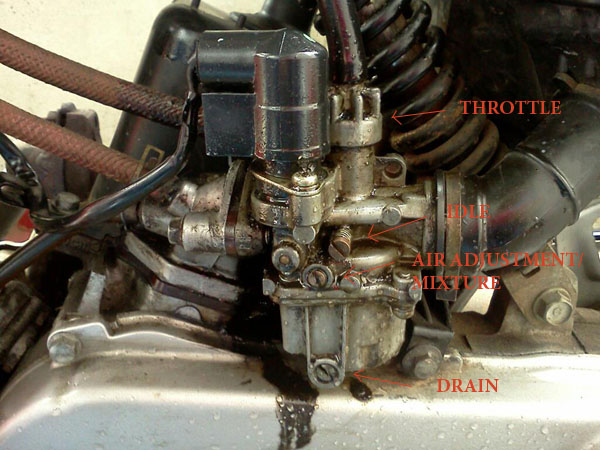

Sorry. 1985 Honda Spree. I read the manual and unfortunatly, I did not record the number of turns on the screws. I messed around with the settings for about half an hour and it just would not idle. I also read that I should start with the idle in most of the way and then adjusting the mixture. I'm thinking this is my problem because if the carb was clogged I'm sure it would not run at all even with the throttle engaged.

Candies wrote:Sorry. 1985 Honda Spree. I read the manual and unfortunatly, I did not record the number of turns on the screws. I messed around with the settings for about half an hour and it just would not idle. I also read that I should start with the idle in most of the way and then adjusting the mixture. I'm thinking this is my problem because if the carb was clogged I'm sure it would not run at all even with the throttle engaged.
if that picture is your carb i would take it off and give it a bath dirt can cause it not to idle, turn ure mixture screw all the way in and then out 1 7/8 turns and then throttle screw around 2 out it doesnt to get it to idle stronger turn idle screw in less idle is out either your idle is too far out or its time to clean her up!

O this pic is before I cleaned it. It's clean now. Thanks I will try that tomorrow.

bakaracer
Posts: 3519
Location: tacoma,wa
Re: Wont Idle
Post by bakaracer »
where is all that oil coming from? that carb spacer looks like its upside down too. or backwards.on side has a oring on it. that faces the manifold. the carb already has a oring on the flange. if its not there then you need another one. test the bystarter too. if thats not work right, the bike wont run right either.

Re: Wont Idle
It looks like the bystarter is not down all the way either.

The oil was because it was leaking oil from the elbow. I fixed that. It's quite possible I put the spacer on wrong :wink: See, the bike worked ok before I took apart carb. As for the testing of the bystarter, I am ill-equipped for that lol

Wait wait wait! This picture is the ORIGINAL before I even touched it! So...it was running off of this carb in the photo before I messed with it and now it WONT idle...ironic isnt it?

abreen89
Posts: 797
Location: Graham,WA
Re: Wont Idle
Post by abreen89 »
if bystarter was bad it would be very hard starting

abreen89
Posts: 797
Location: Graham,WA
Re: Wont Idle
Post by abreen89 »
check your space just make sure it lines up with the inatke and carb rubber to intake. also i think it has a pa logo on it that should face out.
