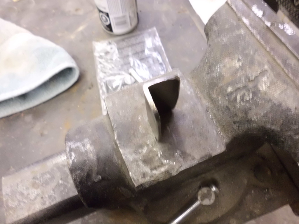

I had to install a coolant tank. so I ordered the "Weapon R" tank the construction is solid,and it is smaller than the password jdm one. man there is no room under these tiny panels...

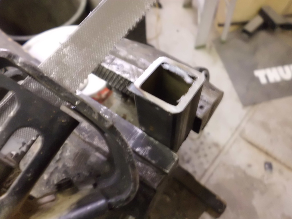

I needed a bracket. so I started with some recycled square stock.
now it is an "L" bracket.

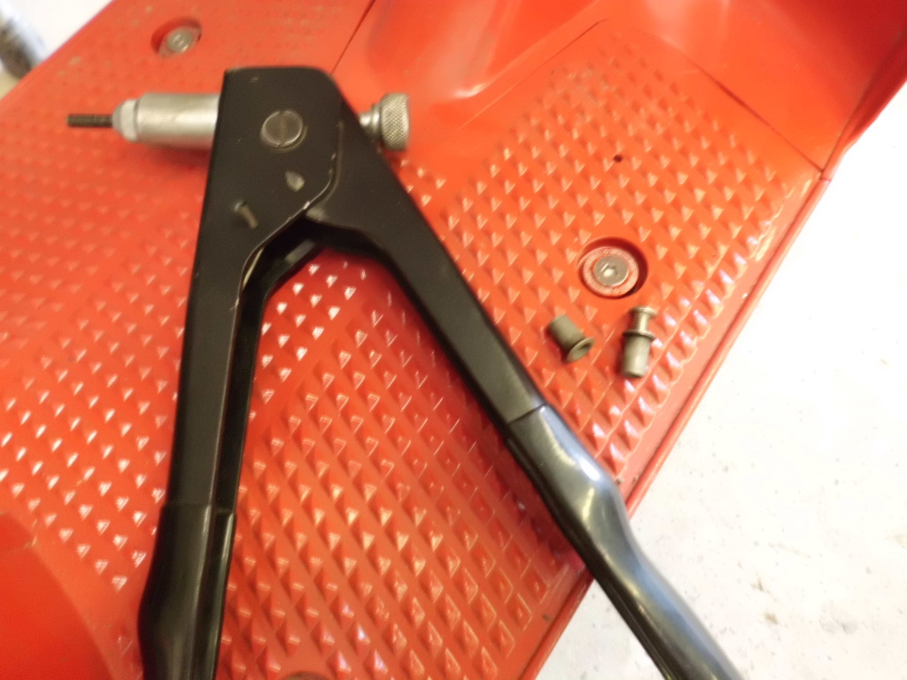

I am using nutserts to install the bracket. they expand in the frame and leave a threaded hole.. they look like this.

here is a photo with one installed. and the hole for the other one.
and here it is fully installed ,one step at a time you know. I painted the bracket orange with "Montana gold, 61250 terra" that paint is awesome by the way...also it is held on with a "sickspeed" washer bolt combo.

Is that a standard pop rivet tool? If so I want to find these so called nutcerts, that seems like a handy addition to my seldom used rivit gun!

Fishman43....look closely at the tool...it has a threaded end sorry bro, this will not work with a regular rivet gun.
We use this setup on aircraft. It is called a RIVNUT Tool. It has a threaded end that srews into the nut, then you insert that into the hole and squeeze it up like a 'pop rivet', unscrew the tool and hey presto your done. A quick google search reveals a few options.
