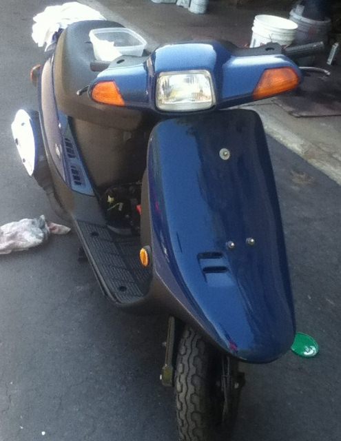

I got the headlight panels done today and she is looking good. Ill post some better pictures later on .
IMG_2395 (495x640).jpg (72.22 KiB) Viewed 5753 times

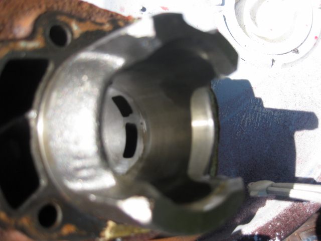

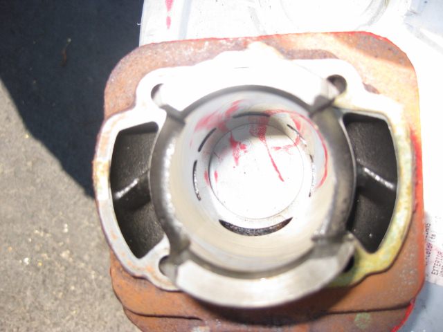

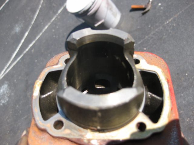

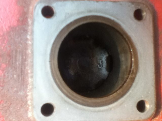

Ok guys I took my cylinder of just now. I really don't know why it will be smoking so bad. Because inside the engine looks so clean like brand new. My pipe got know holes.
Why it will run rough ?
Also will a 1989 SB50P piston rings fit in a 1998 Sa50P Honda elite?

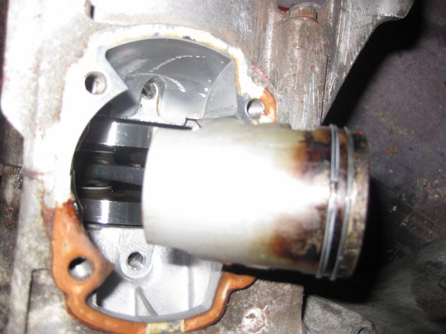

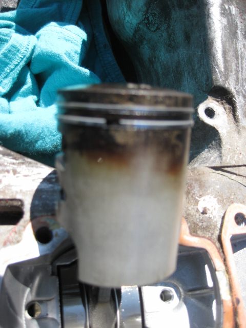

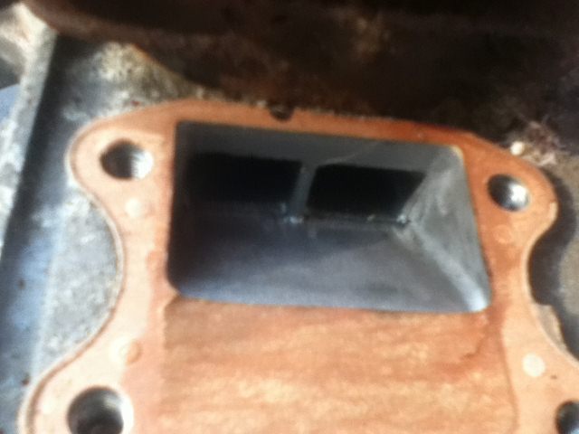

some more pics what it is look like
IMG_0834 (640x480).jpg (66.31 KiB) Viewed 5711 times
IMG_0833 (640x480).jpg (63.52 KiB) Viewed 5711 times

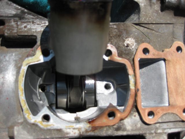

Duke250
Posts: 122
Location: Wisconsin
Re: Some advice here will be very helpful
Post by Duke250 »
more
IMG_0850 (640x480) (640x480).jpg (71.2 KiB) Viewed 5710 times
IMG_0839 (640x480).jpg (39.41 KiB) Viewed 5710 times
IMG_0840 (640x480).jpg (58.65 KiB) Viewed 5710 times

My questions are
WIll a 1989 Honda SB50P piston and rings will fit a 1998 Honda Elite SA50p?
DO I need to change my ring and piston?
Why is it smoking so bad ?
WHy is it running like those tractor with a chains wheels on a hard surface?
