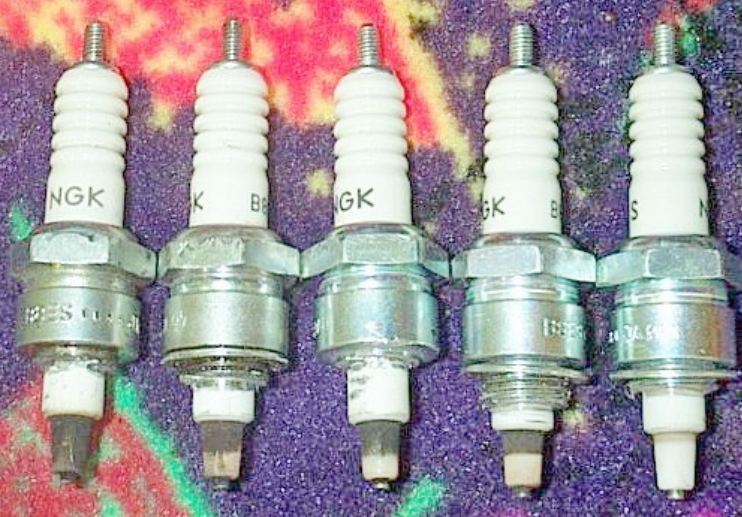

Re: How to read plugs
Plug chop photos from the 'net - rich to lean
