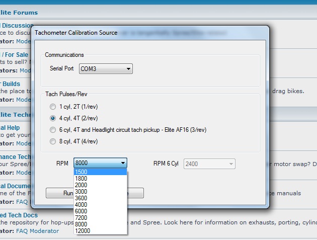

-- PC Serial Port Calibrator --
A while back a tach calibrator was proposed using a serial port + 2 components. A companion file of zero's, and a terminal program were used to generate given RPM references. That approach has been converted to an application supporting 1cyl 2T, 4/6/8 cyl 4T scaling.
-- More accurate analog tach + 10k/11k range --
Looking for a small more accurate tach a 'stepper tach' from Depo was found (Amazon/eBay and others have this model). Likely micro controller controlled, pointer angle is controlled by number of steps the motor is rotated.
Available in 10k and 11k RPM models it eliminates need for internal mods. One thing I'd do change next time: Get the clear lens version rather than 'smoked'. Smoked lens is not very bright in the sun.
The accuracy of this tach provides a good show with the PC based calibrator:
1500 RPM
4000 RPM
8000 RPM
