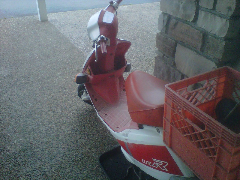

Here we go fixed!
Elite pictures.jpg (213.81 KiB) Viewed 7172 times
NSDreamer
Posts: 13
Joined: Fri Mar 25, 2011 3:59 pm
Location: Nova Scotia
Re: Rebuilding a 89 Honda Elite (Canadian version) 50CC
Post by NSDreamer »
Not in horrible shape eh! Now if only I can get her to run!
Elite 2.jpg (200.04 KiB) Viewed 7171 times
NSDreamer
Posts: 13
Post by NSDreamer »
Last one
Elite 3.jpg (167.95 KiB) Viewed 7170 times

Very cool! I like the Elite R graphics. Give it an epic clean and hit the panels with some wax - it'll come up nicely. I've noticed the footwell panels always look chalky and faded (fuel being spilled on them turns the plastic ugly) I've found giving them a spray with cheap silicon based tyre shine and rubbing it into the plastic with your bare hands goes a long way into reviving the colour. :thumbwink:
