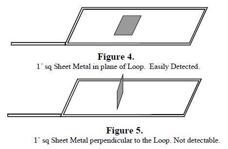

Here's a much better article. I'd never understood the principal of how these inductive loops detect objects, and now understand why bikes and MCs aren't detected. Based on this article, I think I have a fix for this issue, at least for scooters:
http://www.marshproducts.com/pdf/Induct ... e%20up.pdf
I've got an experiment for you. Get a sheet of Al or steel (even aluminum foil might work) and tape/screw it on to the bottom of your footboard, that is, under the frame. Should be 1' x 1' or larger. Make it as big as you can without going over the edge of the sideboards. If done right you shouldn't even be able to see it. See if this will trip the inductive pickup for the light.
Post results back... I'm very interested in this.

Re: Traffic Light Tactics
Good link - thanks :thumbwink:
Al foil, sticky, al tape etc should do fine. As the link mentioned it is the area 'in the plane of the loop'.
Also, this is why bicyclists (at least those with metal frames/spokes) can lay their cycle over to the side to trigger lights.
