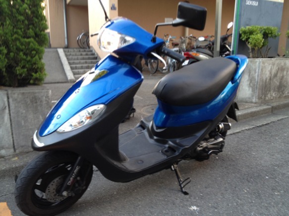

Ok finally an update I have this little b**** of a project completed and am finally really happy with the results!!
Got it tuned with a 45 pilot and a 118 main with needle clip in the middle!
Runs like a bat out of *. Not sure of top speed as there is nowhere I can safely do a top speed run here but it's way fast enough! Keeps up and out accelerates all the 125 4stroke scooters here. So I'm happy.

21mm carb with standard crank stroke!

Sym dd50 build!!
And some pics of the build to date!
